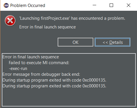

Simple programs compile and run, but debugging runs into the following error:
index.php/fa/32175/0/

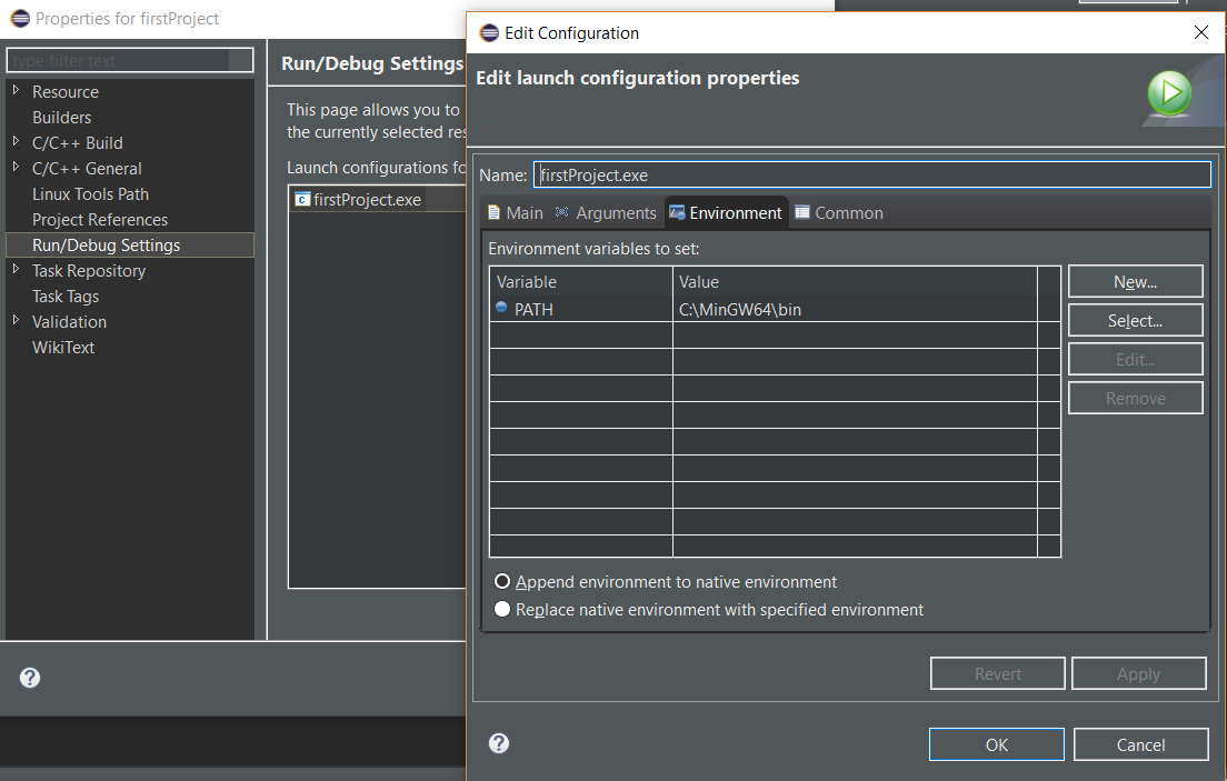

I've set up the run/debug in the same fashion as the paths for build (as shown below)
Thanks in advance for help anyone can provide.

You should learn what the termination values actually mean.
Here are some common ones:
https://blogs.msdn.microsoft.com/joshpoley/2011/06/13/common-process-termination-values/
0xC0000135 means a DLL didn't initialize properly and often means a needed one couldn't be found.
The hard part is finding out which DLL is the cause.
Some possibilities:
https://stackoverflow.com/questions/475148/how-do-i-find-out-which-dlls-an-executable-will-load
https://docs.microsoft.com/en-us/sysinternals/downloads/listdlls
You should also understand how Windows searches for DLL's.
https://msdn.microsoft.com/en-us/library/windows/desktop/ms682586
You shouldn't have to add MinGW to the path.
It's usually in your execution path after installation.
I use MinGW and have never had to add it to the path.
CDT prepends the home directory for MinGW and MSYS to the path for run/debug

Since the original post, I have switched from a laptop to a desktop, reinstalled oxygen.2 and MinGW64 and viola, no problems. At this point I am very happy to have a working alternative to Visual C, but the issue is still a little muddy, since the program in question is basically as follows:
int main()
	return 0;
I don't understand how this program would reference any dll's.
To be sure, I will re-post after working w/ the laptop and checking DLL dependencies on the exe it produces.
