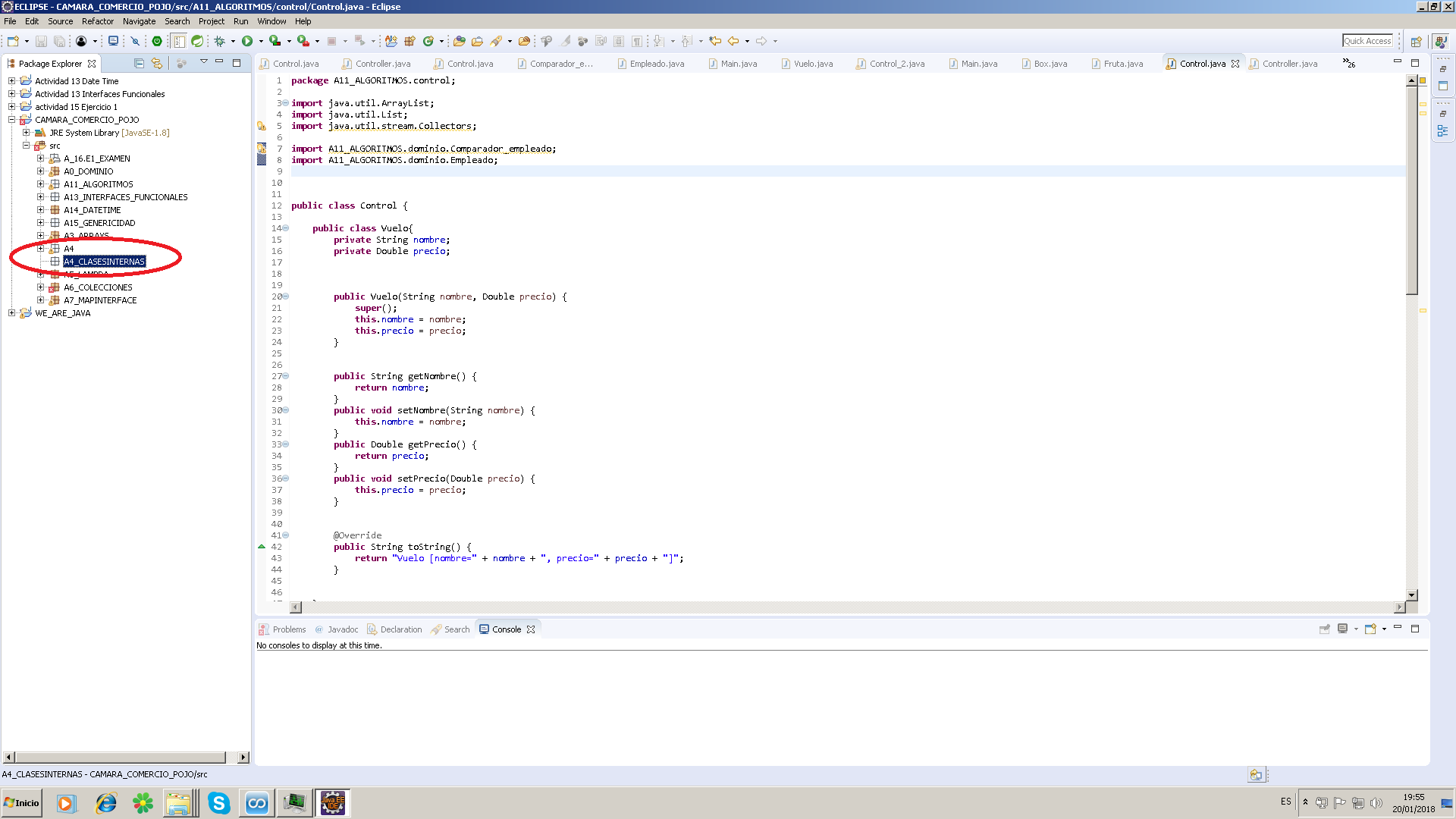

Thanks for your help . but there is not any delay i can stay half hour wathing it and it will not change if i do not create something inside. Also im already using Hierachical view
New bug when i try rename package with other packages inside : check attached
[Updated on: Sat, 20 January 2018 14:03] by Moderator
Re: How to get Package Explorer to match Windows Explorer. [message #1780351 is a reply to message #1780346] Sat, 20 January 2018 16:36 Go to previous messageGo to next message
What are error we supposed to see in that image? Also, this isn't the bug reporting system. That would be bugs.eclipse.org.
