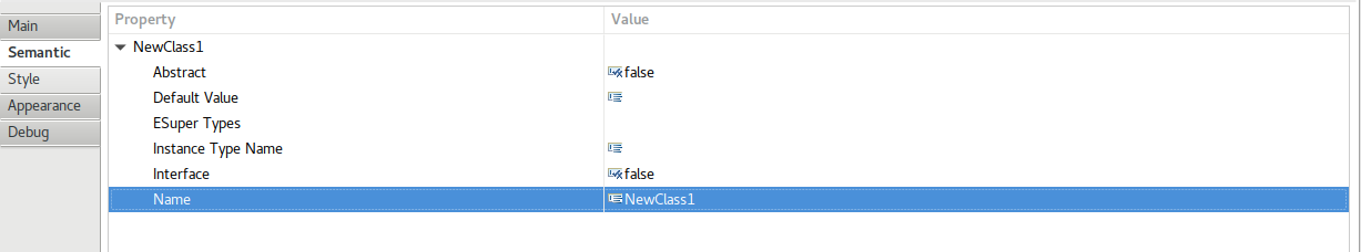

Hi. It's difficult to answer without more information.
If you remove your custom definitions from the .odesign file, and select an element from a Sirius diagram, you should see a "Main" tab with nice widgets showing your properties in addition to the "Semantic" tab which shows a plain property grid.
index.php/fa/31845/0/
index.php/fa/31846/0/
The Main tab is produced by EEF using default rules when nothing specific is defined in the .odesign. If it does not show up, the problem may be in your installation (some parts missing?) or setup.
If the Main tab show up, then the problem you see is probably in your own definitions on the .odesign.
