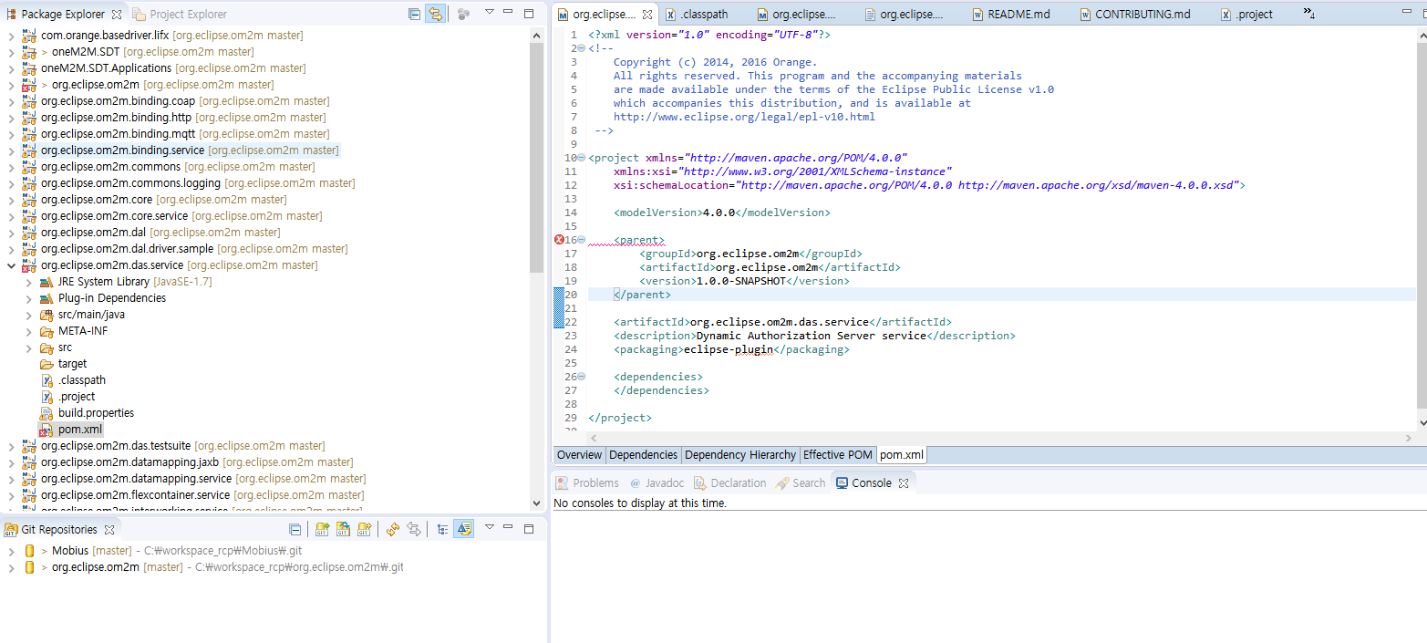

here is additional info :
when i view my pom.xml on org.eclipse.om2m.das.service project.
there is an error on pom.xml
Project build error: Non-resolvable parent POM for org.eclipse.om2m:org.eclipse.om2m.das.service:[unknown-version]: Could not find artifact org.eclipse.om2m:org.eclipse.om2m:pom:1.0.0-SNAPSHOT and 'parent.relativePath' points at wrong local POM
https://drive.google.com/open?id=1t7Ty_JVNXhG9Bh462iE53KU6HYwpqzKW
can anyone help me?
