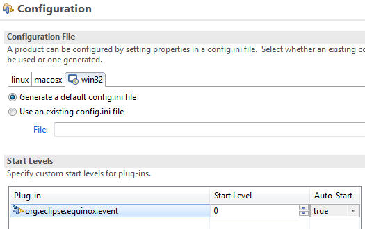

We started seeing this problem, too, after upgrading to Eclipse 4.7.3. Turning autostart to 'true' in the run configuration didn't work for me, either, but deleting the run configuration, and changing the product definition to turn autostart on for "org.eclipse.equinox.event", and re-creating the run configuration, did.
index.php/fa/32449/0/
  • Attachment: Capture.PNG
    (Size: 14.44KB, Downloaded 2354 times)
