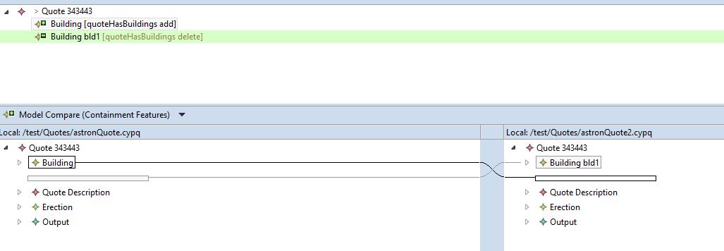

I have my own EMF model.
In my RCP application, I just created a model 1.
Copy Paste my model 1 to model 2.
Change one simple name property of my Building object in the model 2.
You can see the comparison result:
instead of finding the attribute modification, EMF Compare found an addition and a deletion of the building.
I suppose there is a solution?

If your model has no identifier, EMF Compare tries to match elements using metrics to compute the "similarity" between your elements. In this case, the two Building objects are too different to match, so EMF Compare doesn't see them as being "the same" and you get an add and delete differences.
You will have to either make sure your models use identifiers or customize the proximity engine for your needs if it doesn't work for you.
