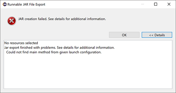

I receive this error while using the Runnable JAR File Export Wizard to export a small java application (File-> New-> Java Project) with GUI made with WindowBuilder (File-> New -> Other ->WindowBuilder-> Swing Designer -> Application Window):
index.php/fa/31480/0/

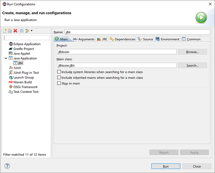

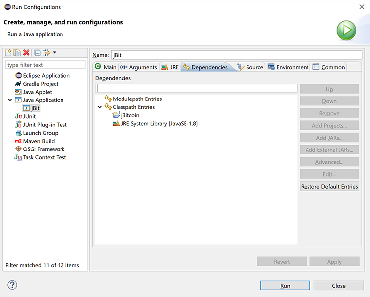

This is the current Run Configuration I'm using:
index.php/fa/31481/0/
index.php/fa/31482/0/
I don't really know why it can launch normally the application but not exporting it as runnable jar, please note Project and Class (under the Main Class tab in the first image) are correct.
