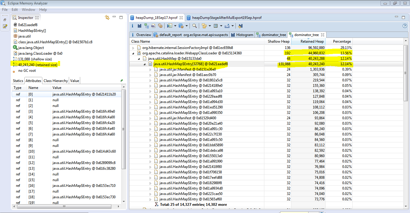

Re: Need help to fix the Spring SessionFactoryImpl Memory leak with Eclipse Memory Analyser [message #1773103 is a reply to message #1773007] Thu, 21 September 2017 10:14 Go to previous messageGo to next message
Thanks a lot for the help. As mentioned I would like to increase the HEAP size and see if it all goes well.
Also please let me know what exactly is causing the WebClasscloader to occupy 40M, could you please let me know how to trace the HashMap and find out what are the objects holding back in memory and why this HashMap is occupying 40M memory.
Please find the screen shot attached.

Re: Need help to fix the Spring SessionFactoryImpl Memory leak with Eclipse Memory Analyser [message #1773261 is a reply to message #1773103] Mon, 25 September 2017 14:23 Go to previous messageGo to next message
Can somebody please help how to analyse the hashmap[] consuming 40mb memory, please see the screenshot attached in the previous thread
Re: Need help to fix the Spring SessionFactoryImpl Memory leak with Eclipse Memory Analyser [message #1773264 is a reply to message #1773261] Mon, 25 September 2017 14:56 Go to previous messageGo to next message
Have you tried "Show retained set" on the HashMap in question?
E.g.: https://www.ibm.com/developerworks/community/blogs/kevgrig/entry/advanced_heapdump_analysis_retained_sets
Re: Need help to fix the Spring SessionFactoryImpl Memory leak with Eclipse Memory Analyser [message #1773289 is a reply to message #1773264] Tue, 26 September 2017 02:22 Go to previous messageGo to next message
I have tried the "Show retained size" as mentioned below, Please find the document attached.
Kindly please help.
-Hari
