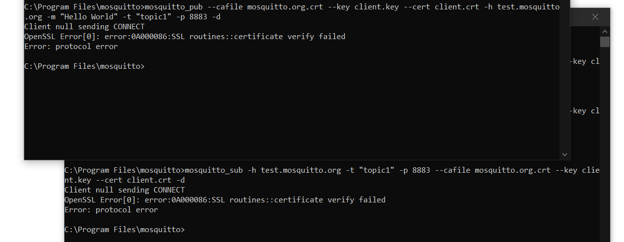

Thank you, it work!
But first time i ran these commands it works fine.
And second time I ran these commands it give me these errors.
OpenSSL Error[0]: error:0A000086:SSL routines::certificate verify failed
Error: protocol error
  • Attachment: Capture1.PNG
    (Size: 29.48KB, Downloaded 324 times)
