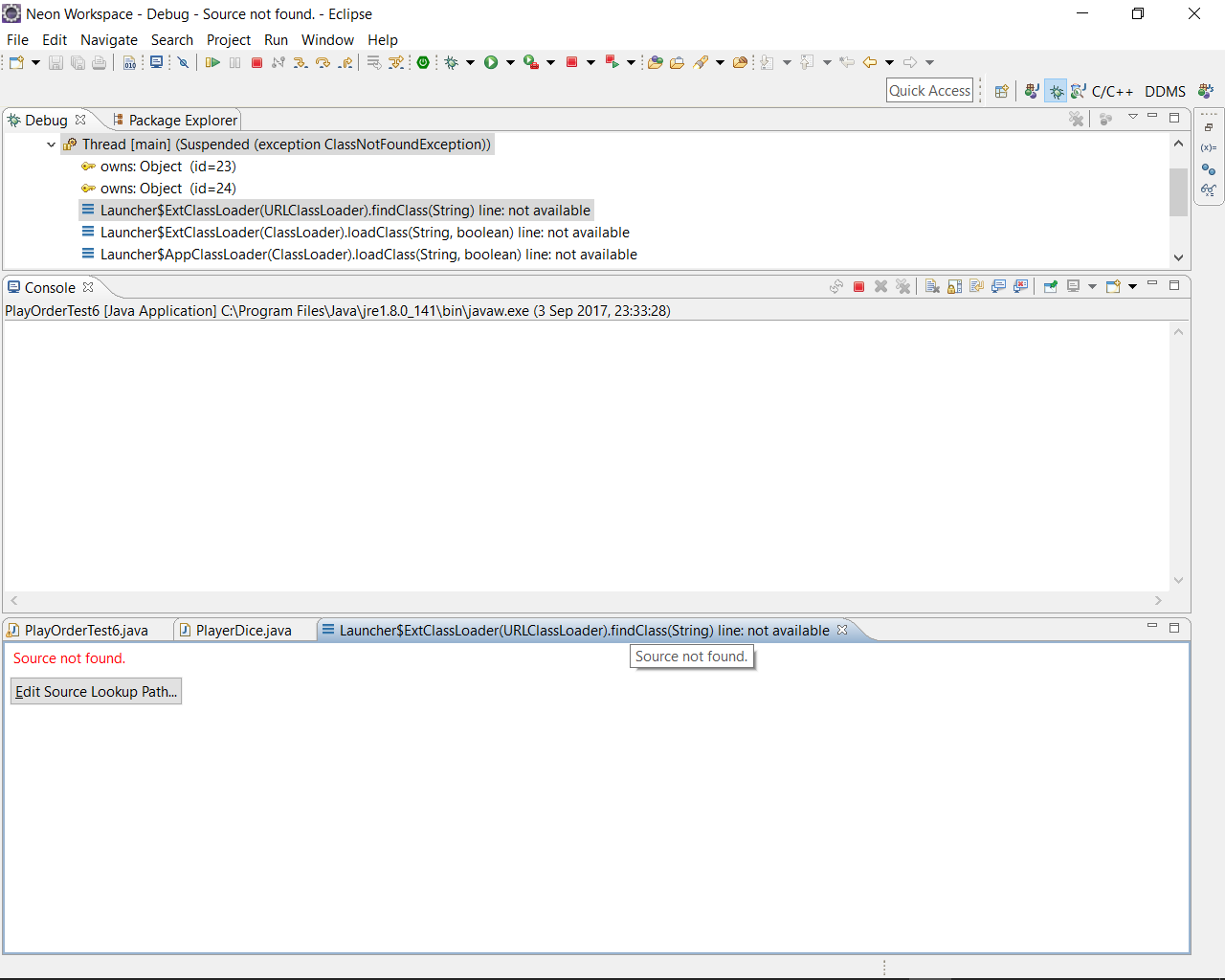

I was adding an alternative class and associated main class to an existing project (whose development intensively used the Eclipse Debug function) and encountered this hassle when using Debug to trace a bug.
It opens the Debug environment all right but shows a "Source Not Found" error.
Unfortunately, it does not provide a name for what is missing !

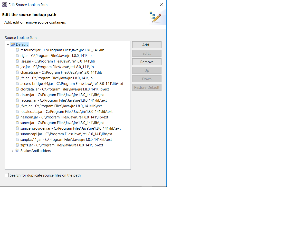

When I click on the "Edit Source Lookup Path" I get what i should get, i.e. a path to the src folder for my project.

It's looking for the source to "Launcher".

I see that, Nitin.
But it has the source path to the 'main' class for this app - so what's the problem ?

Re: Eclipse Debugger . . . "Source Not Found" [message #1772059 is a reply to message #1772048] Tue, 05 September 2017 02:23 Go to previous messageGo to next message
What kind of launcher is this? I.e., under Run -> Debug Configurations... which group is it in? Is it in "Java Application"? If it's under "Eclipse Application" then you can't modify the classpath of the project explicitly, but must edit the MANIFEST.MF using the "Run" tab to add libraries to the .classpath of the plugin so that those libraries can be found by at runtime.
Re: Eclipse Debugger . . . "Source Not Found" [message #1772078 is a reply to message #1772059] Tue, 05 September 2017 06:37 Go to previous message
JC, it's being launched as a Java Application. I see no option for Eclipse Application.
The classpath tab is what it should be - it holds paths to both the project folder and the most recent JRE.
Plainly some update to Eclipse Neon has changed the whole process for doing a Debug.
