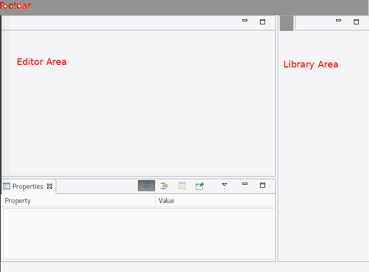

In my RCP I have project and library based on sirius tree. The User can drag an drop item from the library tree to the project tree. This works fine and was no great problem to build in. So now I want to make the UI more usable. It should looks like this layout:
After application startup i open my library presentation with the DialectUIManager.
final DialectEditor editor = (DialectEditor) DialectUIManager.INSTANCE.openEditor(siriusSession, description, monitor);

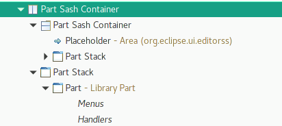

Okay, this work also. But it open it in the editor in part market as org.eclipse.ui.editorss. This it not what I want
I want to show it in the "Library Part". I can move it manually after open the editor, but how can i tell DialectUIManager the to open it direct there?
