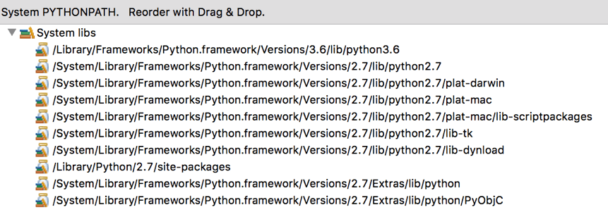

Next, within Eclipse, Preferences, PyDev, Interpreters, Python Interpreter,
I added and moved to top, the path to the /Library framework for python3, so it looks like image1.

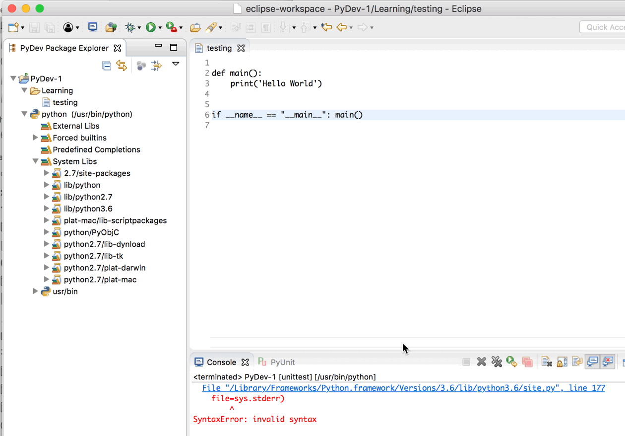

FINALLY, obviously ignorantly, I thought I was ready to go.
NOT!
In image2 you'll see my layout, the console, and my complicated (sic) program.
index.php/fa/29906/0/
THE Q) How can I get this to work?!

I'm guessing your interpreter is set to python 2 and is choking on your python 3 lib as your error seems to indicate. Remove python 3 lib from the dependency and try it. If you need to use python 3, configure the interpreter for python 3 and remove the python 2 libraries.
