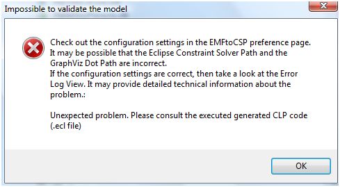

When I input the below ocl program to "EMFtoCSP" tool. I have the bellow error:
import Families : 'Families.ecore'
package families
context Member
inv ocl1 : not familyFather.oclIsUndefined()
endpackage
index.php/fa/29672/0/
However, when I input another ocl program it works fine. It seems something was wrong in my ocl program although it has no syntax error.
I attached the metamodel.

The message offers two possible non-OCL reasons for the unexpected error. Further advice is to look at the *.ecl.
You might try familyFather <> null to avoid dependence on the troublesome invalid concept.
Otherwise debug the exception in the EMFtoCSP tooling.

When I tried "familyFather <> null", the error disappears. my problem was solved.
However, when I write "familyFather = null", the error appears. How should I write it?
