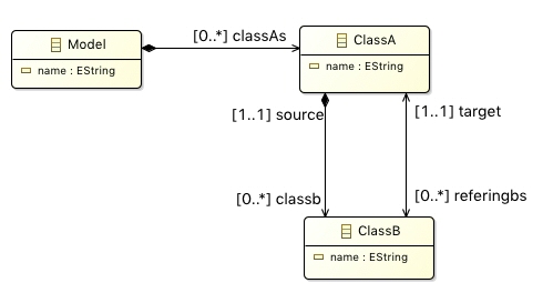

Hi everybody,
I have this metamodel
index.php/fa/29579/0/
I create a Xtext grammar from this metamodel

My models are saved as XMI using a mechanism described in previous posts (That is not the issue).
The problem comes from the "referingbs" reference which is an eopposite reference to "target" reference.
When I create a model containing an instance of ClassB that refers to ClassA instance via target reference,
Xtext throws an error

Please any suggestion/idea?
best
Re: manage eopposite references coming from imported metamodel [message #1765247 is a reply to message #1765246] Wed, 07 June 2017 16:33 Go to previous messageGo to next message
No you have ask ed. Did you have a look at the model before saving to xmi
Is it ok are both refs set. Afaik you have to do this manually right?
Re: manage eopposite references coming from imported metamodel [message #1765249 is a reply to message #1765247] Wed, 07 June 2017 16:38 Go to previous messageGo to next message
So to say: is the model correct after Xtext (re)parsed it
Another thing for a simple unit test
And I have a dejavue feeling that you already had solved this a week ago

Re: manage eopposite references coming from imported metamodel [message #1765251 is a reply to message #1765249] Wed, 07 June 2017 16:47 Go to previous messageGo to next message
the re-parsed model doesn't show errors but a wizard appears showing the error.
Christian, the attachment shows a demo explaining the complete scenario

Re: manage eopposite references coming from imported metamodel [message #1765258 is a reply to message #1765255] Wed, 07 June 2017 17:05 Go to previous messageGo to next message
The test is correct.
However, the println shows
Re: manage eopposite references coming from imported metamodel [message #1765260 is a reply to message #1765258] Wed, 07 June 2017 17:07 Go to previous messageGo to next message
yes and this means the test is not correct, it should print the b right?
Re: manage eopposite references coming from imported metamodel [message #1765262 is a reply to message #1765260] Wed, 07 June 2017 17:09 Go to previous messageGo to next message
Yes. it should print the classb1 object
Re: manage eopposite references coming from imported metamodel [message #1765263 is a reply to message #1765262] Wed, 07 June 2017 17:23 Go to previous messageGo to next message
and i thought we were already at this point 2 weeks ago with the fsm stuff.
class MyDslDerivedStateComputer implements IDerivedStateComputer {
	override discardDerivedState(DerivedStateAwareResource resource) {
		if (!resource.contents.empty) {
			val model = resource.contents.head as Model
			for (a : model.classAs) {
				a.referingbs.clear
	override installDerivedState(DerivedStateAwareResource resource, boolean preLinkingPhase) {
				println(a.name)
				for (ai : model.classAs) {
					for (bi : ai.classb) {
						val name = NodeModelUtils.findNodesForFeature(bi, MyDslPackage.Literals.CLASS_B__TARGET).head?.text?.trim
						println(name)
						if (a.name == name) {
							println("found")
							val EObject proxy = EcoreUtil.create(MyDslPackage.Literals.CLASS_B)							(proxy as InternalEObject).eSetProxyURI(EcoreUtil.getURI(a));
							(proxy as InternalEObject).eSetProxyURI(EcoreUtil.getURI(bi))
							a.referingbs += proxy as ClassB
(dont know how this stuff will behave cross file, maybe you need another approach for that - maybe ed can help)
Re: manage eopposite references coming from imported metamodel [message #1765264 is a reply to message #1765263] Wed, 07 June 2017 17:35 Go to previous messageGo to next message
Yes Christian, but in the fsm stuff, the first part MyDslTransientValueService misses
what do you mean when you say "cross file"?
Re: manage eopposite references coming from imported metamodel [message #1765268 is a reply to message #1765264] Wed, 07 June 2017 17:52 Go to previous message
If b and a are in a different file you cannot search matching a and bs the way I do
