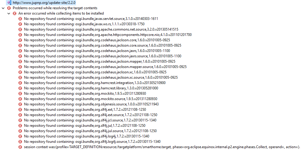

I'm trying to set up a development environment, following the instructions here https://www.eclipse.org/smarthome/documentation/development/ide.html
I have tried this a number of times and each time I end up with many many errors in my workspace. I have run through all the way to step 9.
I suspect the issue might be related to null pointer exceptions it gets early on:

which I suspect is a knock on error. I get the same errors if I try and look at the target definition within the "targetplatform" project and try and reload that. IN the "Target Definition" editor I get a bunch of errors "Problems occurred while resolving the target contents", see the attached image. I', assuming that they are the result of the "install download" errors.

Re: NPE trying to set up ESH development envirionment [message #1765098 is a reply to message #1765062] Tue, 06 June 2017 10:31 Go to previous message
Interestingly, I tried again this afternoon, and the NullPointerExceptions have gone. My surmise is that something was offline this morning that it was trying to download from.
However, I still get a bunch of errors.
I reran "Help->Perform Setup Tasks", and then selected the projects with red crosses and cleaned just those. Less errors than last time, but still errors.
Looking into a few of the errors, some code generation clearly hasn't been performed. The "org.eclipse.smarthome.model.thing" project for example has an error "Missing required source folder 'src-gen'" that is stopping it being built.
I've tried rerunning "Help->Perform Setup Tasks" *again* on the off chance it works. Hmm, this time it seems to have done. That's odd.
I now have no red crosses!
No idea why it required me to do the same thing about 4 times to make it work, but it seems to have done.
