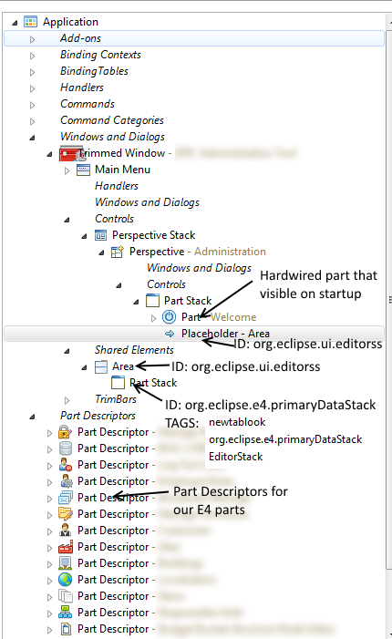

Currently, my XMI looks like this:
index.php/fa/29396/0/
Of course the Area cannot be a child of a Part Stack, but for some reason, despite the above exception this configuration works as desired.

Can you suggest me a layout that looks as desired and does not violate the application XMI rules? In any other ways the perspective was split up to multiple areas/stacks.

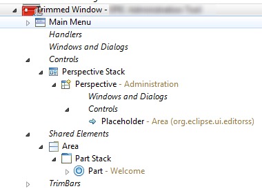

And for the layout I described, the solution was to put the 'Welcome' part in the part stack of the shared area, and let the placeholder be the only child of the perspective. Now it works fine:
index.php/fa/29544/0/
