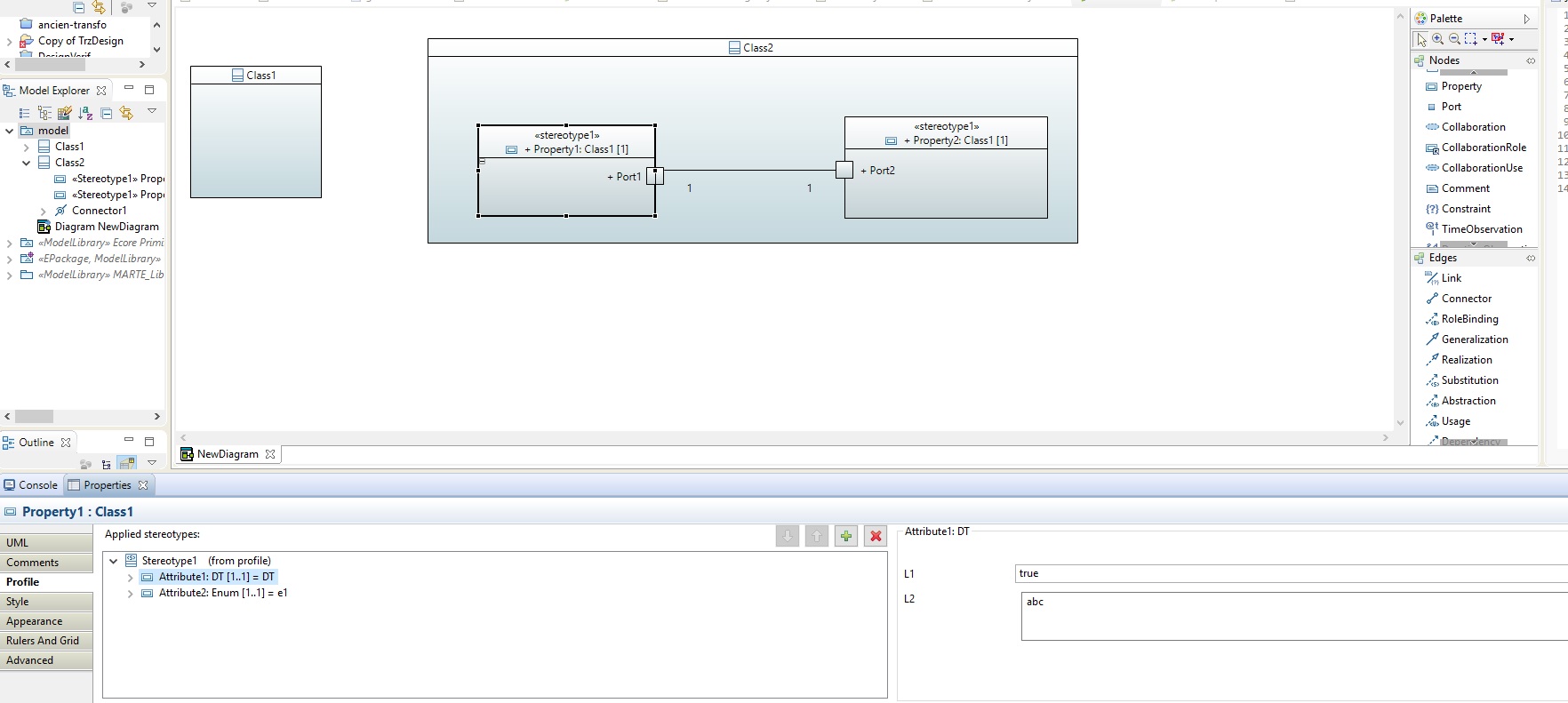

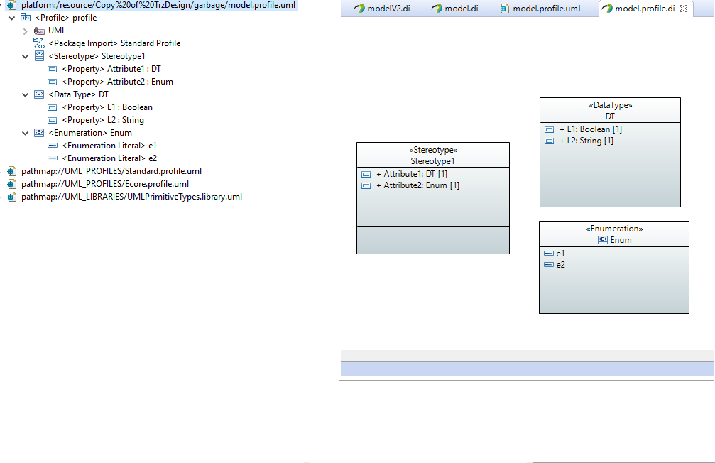

Re: how can we get DataType values in Acceleo [message #1760443 is a reply to message #1760440] Thu, 27 April 2017 07:09 Go to previous messageGo to next message
I apologize for my quick reply.
I'll try to make more effort to be clearer as possible. I attached to my reply my model (screenshot + zipped file) as I created it in Papyrus, showed the applied stereotype with its properties as I explained in my first request.
The code I wrote is a real MTL code file, I intentionally added color=red in the first request to highlight the problem (which is data type), before I changed the [code format.

private p2 =DT;
Attribute1 is a DT not a DataType. DT is a profile type that doesn't seem to be known to Acceleo; presumably needs a cleverer import. Perhaps Acceleo can only cope if the profile is statically generated.
Anyway using eClass() works fine.
