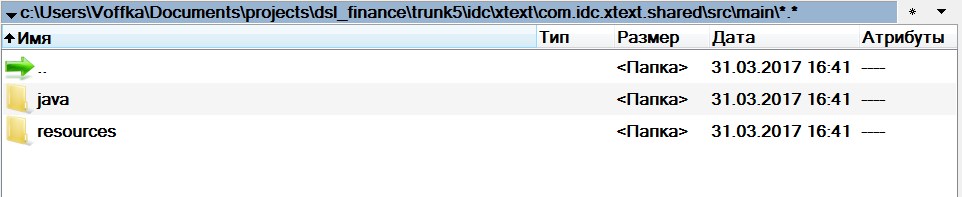

And following structure of the project
index.php/fa/28983/0/
When I try to load the image with following code, I have null pointer exception.

Look like some problem with the path to file.
But why and how I can to fix it?
