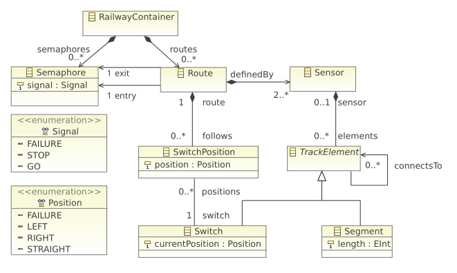

In the past days, i tried to use viatra to copy the TTC model, but when i copy elements of Switch and Segment, it is hard to implement the self-reference 'connectsTo' with vql and xtend. Could you offer me any advice? Or could you show me an example?
The attachment is the meta-model of TTC, you can refer to is.

I don't really understand what are you trying to achieve here. In general, self-references can be easily extended in VQL using two variables, like `Switch.connectsTo(a,b);` or even `Switch.connectsTo(a,a);` depending on what you want to achieve. If you provide a more precise use case, I would be better equipped to suggest a use.
However, if you only want to copy the model (or a subtree of it), you could also have a look at the EcoreUtil#copy static method provided by EMF.
