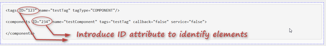

** I want to generate unique ID's for each EMF model element without disturbing the referencing mechanism of the EMF model (as we have name based referencing mechanism for the mdoel elements - instead of ID based)
index.php/fa/28831/0/

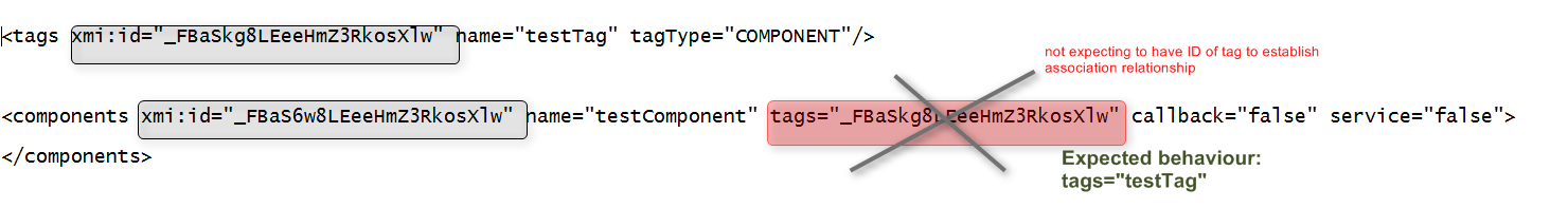

I used below code to set ID's for each element, but unfortunately below code is disturbing the referencing mechanism and setting generated ID at the place where reference should be specified.
private void visitElements(Resource inputSource) {
		if(inputSource instanceof XMLResource){
			TreeIterator<EObject> allContents = null;
			if(inputSource instanceof Resource){
				allContents=  EcoreUtil.getAllContents(inputSource, true);
			for (final TreeIterator<EObject> iter = allContents; iter.hasNext();) {
				final EObject element = iter.next();
				((XMLResource)inputSource).setID(element, EcoreUtil.generateUUID());
index.php/fa/28832/0/
Input Model:
<tags name="testTag" tagType="COMPONENT"/>
<components name="testComponent" tags="testTag" callback="false" service="false">
</components>
Expected change in Model:
I am looking for EMF attribute (at EObject level - valid as per XMI schema: for storing ID ) which can be used in the serialized EMF model without impacting the validity of the model XMI and without changing the referencing mechanism (name based references) which is predefined.

If you use xmi:id, you must use xmi:id and indeed you do. I see nothing wrong with your wrong usage apart from poor human readability.
If you want readability and/or stability, you may choose to code an xmi:id generator that exploits the semantics/hierarchy to give unique names that are readable.
You should find that you only interfere with EMF referencing capability if you set xmi:ids on one Resource and neglect to save other Resources that reference it.
What are you really trying to achieve in comparison to default EMF functionality? Readability/compactness/stability/... Do you really need it? I suggest that this is a premature optimization that you should defer until you have much more experience with using EMF.
