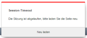

We have deployed our application on a Websphere WAS.
Our users have observed the following behaviour multiple times:
  • in the morning they fire up their browser, access our scout application and log in
  • they can work with the application
  • they let the application "sit" in the browser without using it for some hours (not closing the browser, not closing the tab)
  • some hours later they come back and choose the URL of the scout application from their bookmark
  • they get a session timeout message
  • clicking the "reload" button just leads to the same message again and again
  • closing the browser tab and trying to load the URL again shows the same behaviour
  • starting a different browser (i.e. firefox instead of chrome) let's them log in again
index.php/fa/28807/0/
Is this something you've seen before? Is this a websphere issue? Or rather something in the Scout code (ours or BSI's)?
On a related note: We have four scout applications running on our Websphere (same hostname but different ports): We modified the Login-box.js to use standard JEE login/logout (j_security_check with j_username and j_password). When a user logs into one of the four applications and then openes the URL for any of the other applications he gets into the application without having to log in (while this is a nice side effect as the product owner wants single sign on, it is not what we would have expected). If we then log out from one application and try to do something in the other application, we get a popup showing a http 500 error, even though we can still start the same application (and login) in another browser.
Could these issues be related?
