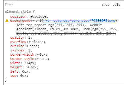

If you set the background image, the developer tools in Chrome mark the background style of the div containing the canvas as an "invalid property value", though (rf. attached image).

From the developer tools in Chrome I see, that the gradient is in fact a CSS background-image property. Same as the actual image I set with setBackgroundImage.
So there is a conflict between those two properties.
"background" is a compound property which should contain either a background image OR a gradient, not both. in _pushBackgroundGradient the background gradient is only set, if no backgroundImage has been set.
In my opinion, the gradient implementing the background color should not be set, if a background image has been set.
