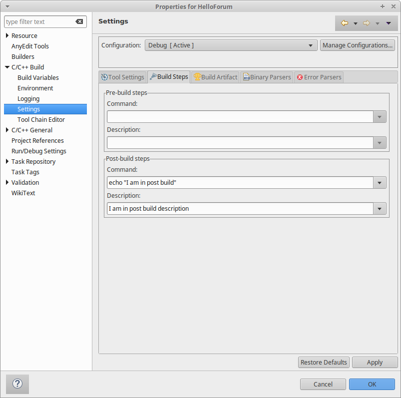

Re: Looking for example of "Post-build steps" [message #1749035 is a reply to message #1749034] Thu, 01 December 2016 05:46 Go to previous messageGo to next message
PS just to be clear, I don't know a way to run a command on /every/ .o file created as it is created. i.e. post-build each .o instead of post-build everything
Re: Looking for example of "Post-build steps" [message #1749036 is a reply to message #1749034] Thu, 01 December 2016 06:09 Go to previous messageGo to next message
Jonah,
Could you, please, provide me with screenshot of "Post-build" window ... as I did it in my 1st message. Thanks in advance.
Re: Looking for example of "Post-build steps" [message #1749038 is a reply to message #1749036] Thu, 01 December 2016 06:37 Go to previous messageGo to next message
Here you go:
index.php/fa/27752/0/
  • Attachment: forum.png
    (Size: 63.90KB, Downloaded 11979 times)
Re: Looking for example of "Post-build steps" [message #1749039 is a reply to message #1749038] Thu, 01 December 2016 06:42 Go to previous messageGo to next message
If it helps, this is what is added to my makefile:
post-build:
	-@echo 'I am in post build description'
	-echo "I am in post build"
	-@echo ' '
.PHONY: all clean dependents
.SECONDARY: post-build
(the .PHONY line is always there, the new stuff is above and below that)
