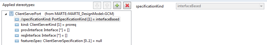

How to change ClientServerPort specification kind from Interface-Based (default setting) to feature-Based when the drop-down list is stamped.

The leading "/" indicates that the interface-kind is a derived attribute, i.e. it is calculated from other values.
In case of the client-server port in MARTE, the calculation will set the specification kind automatically to feature-based, if the port does not have a UML type, but the MARTE featureSpec attribute is assigned.
