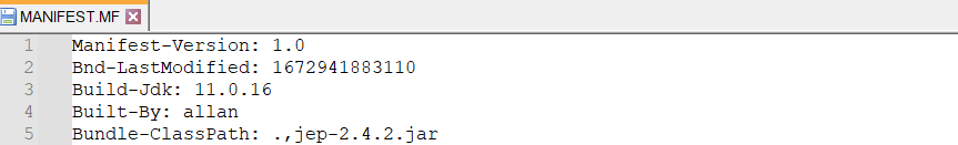

Re: Problem while adding libraries to xtext Project [message #1856861 is a reply to message #1748363] Thu, 05 January 2023 13:18 Go to previous messageGo to next message
Hello, Im having the same problem while running the jar file I created
Should I manually add the libraries in the manifest of the jar? and what libraries?
Re: Problem while adding libraries to xtext Project [message #1856885 is a reply to message #1856861] Sat, 07 January 2023 05:00 Go to previous message
There should be exports for the stuff you want too (runtime tab in manifest editor )
You also need to make sure the jar is packaged (build.properties)
