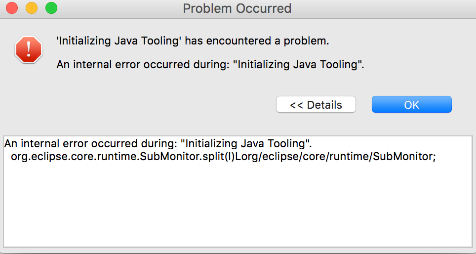

I am trying to install ESH on my MAC without success (following these instructions: http://www.eclipse.org/smarthome/documentation/development/ide.html). Before I post the errors, does anyone succeeded installing it on Sierra MAC version?

Hi Dan
Thx for the reply.
I suspect that the issue relates to some of the tooling but I don't know how to solve it (See attached file).

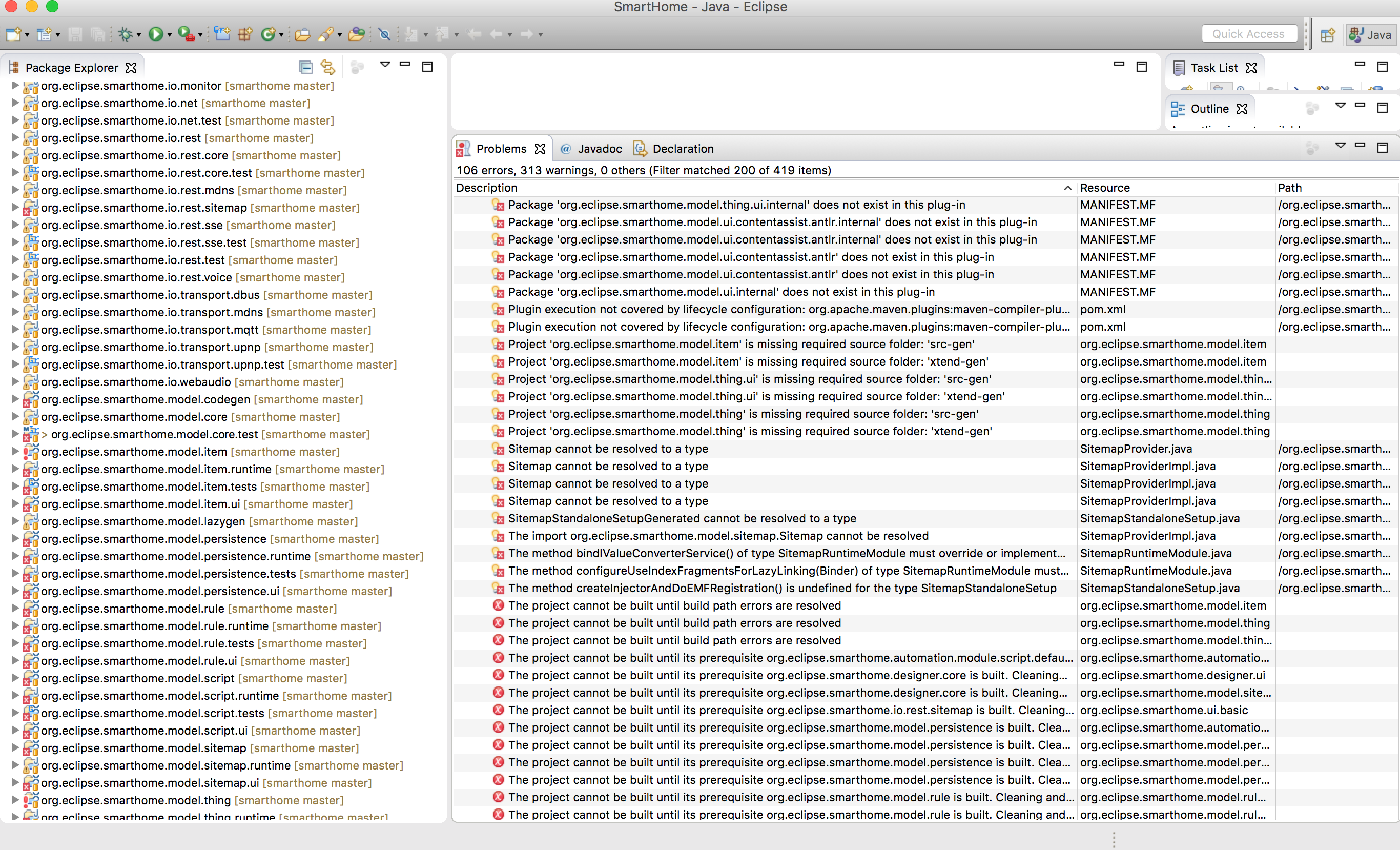

Re: Installing ESH on MAC Sierra (10.12.1) [message #1747553 is a reply to message #1747548] Tue, 15 November 2016 16:09 Go to previous messageGo to next message
And here you can see more errors I get

Re: Installing ESH on MAC Sierra (10.12.1) [message #1747632 is a reply to message #1747553] Wed, 16 November 2016 10:59 Go to previous message
You mention above that you want to setup the IDE (https://www.eclipse.org/smarthome/documentation/development/ide.html), but your logs are from a Maven build on the command line.
Did you hence succeed in the IDE setup already?
