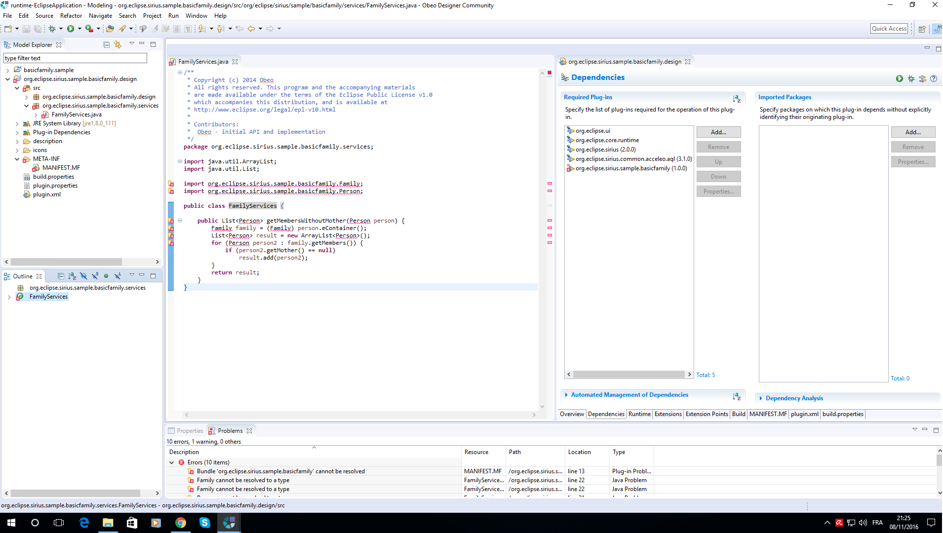

Hi everyone !
I got the following error when i am trying to open the basicfamily Viewpoint Specfication Project.
index.php/fa/27536/0/
index.php/fa/27535/0/
For some reasons the metamodel plugin cannot be found.

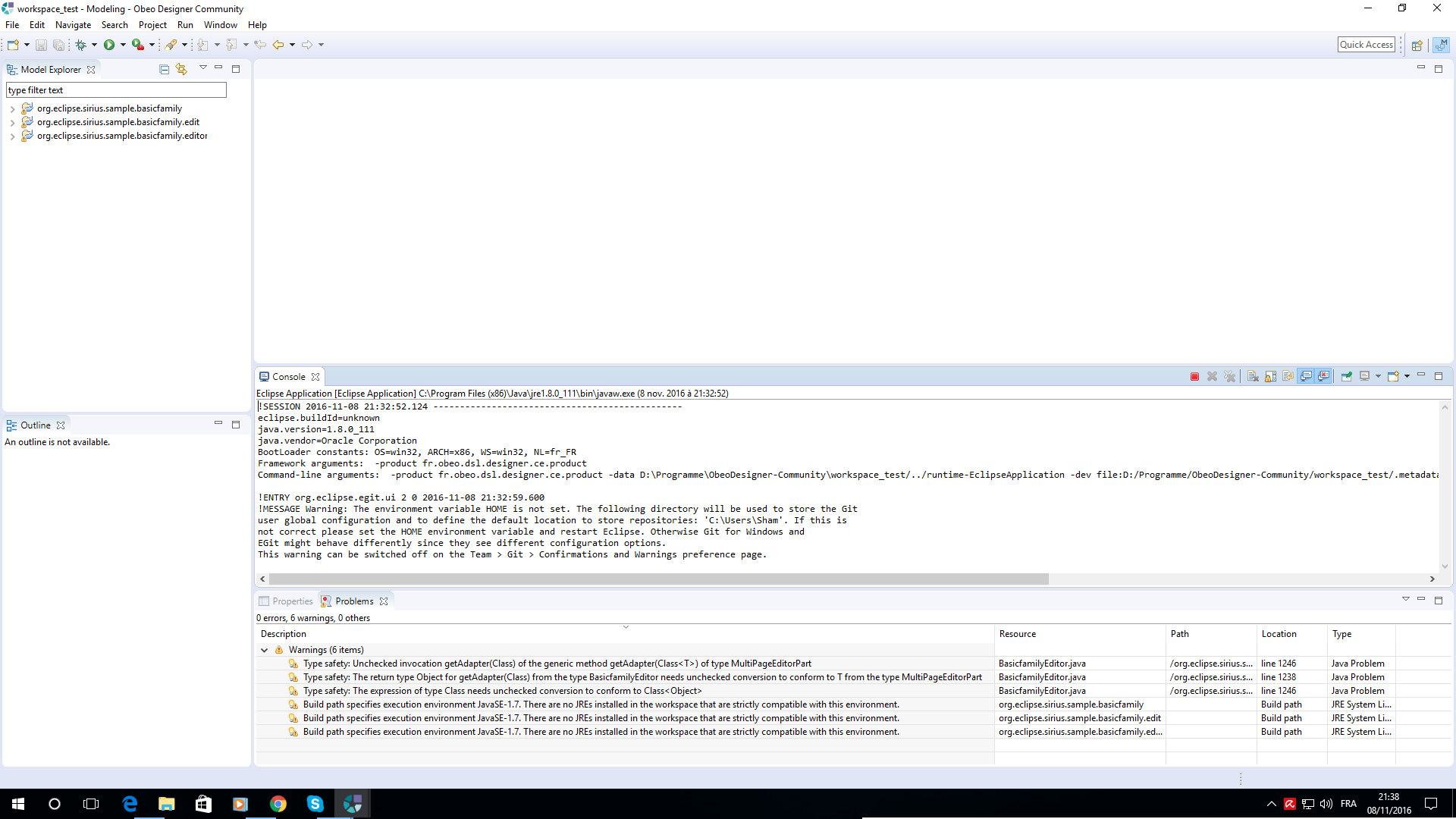

I have no particular idea. With a new OD CE, I have exactly the same first screenshot (in workspace). But in the runtime, when I create the new example "Basic Family Sample Modeler Definition", I have no compilation problem.
Did you customized the launch configuration?
In the "Plug-ins" tab of launch configuration, is "Launch with: all workspace and enabled target plug-ins" checked?
In this tab, if you select "Launch with: plug-ins selected below only", is "org.eclipse.sirius.sample.basicfamiliy visible and checked?
Laurent Redor - Obeo
Re: bundle 'org.eclipse.sirius.sample.basicfamily' cannot be resolved [message #1747128 is a reply to message #1747062] Wed, 09 November 2016 14:15 Go to previous message
I reinstalled ObeoDesigner and it fixed the problem. I can't figure out what I did wrong in the first place.
