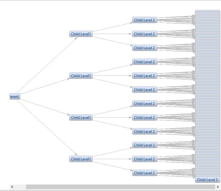

I have currently some problem with tree and HorizontalTreeLayoutAlgorithm.The problem is when there is multiple graph node, join with a all nodes.
All Graph node are at leaf level node overlapped on each other.

In the output screen the nodes of the graph on level 3 are overlapping.
How to avoid this?

Well, there are multiple possibilities: 1) Allow the layout algorithm to position nodes outside of the viewport (applyLayout() takes width and height parameters), and use scaling or scrolling to make it accessible; 2) Allow the layout algorithm to resize nodes, so that the children on level 3 are resized to fit the viewport (however, their labels will not be readable); 3) Hide/Show elements depending on context information so that the graph is not as polluted as it is if all information is shown (possibly utilizing context menus); 4) Use a different layout algorithm that better utilizes the available space.
If you are developing a new application, maybe it is worth to take a look at the new GEF Zest [1]. You will need to make some efforts in order to get a satisfying visualization with either technology. However, the new GEF Zest already provides scrolling and a layout-bounds property. So increasing the area in which the nodes are layed out should be relatively easy. It also provides a HidingModel that can be used to hide nodes and edges, so that restricting the visualization to the currently needed nodes should be relatively easy.
