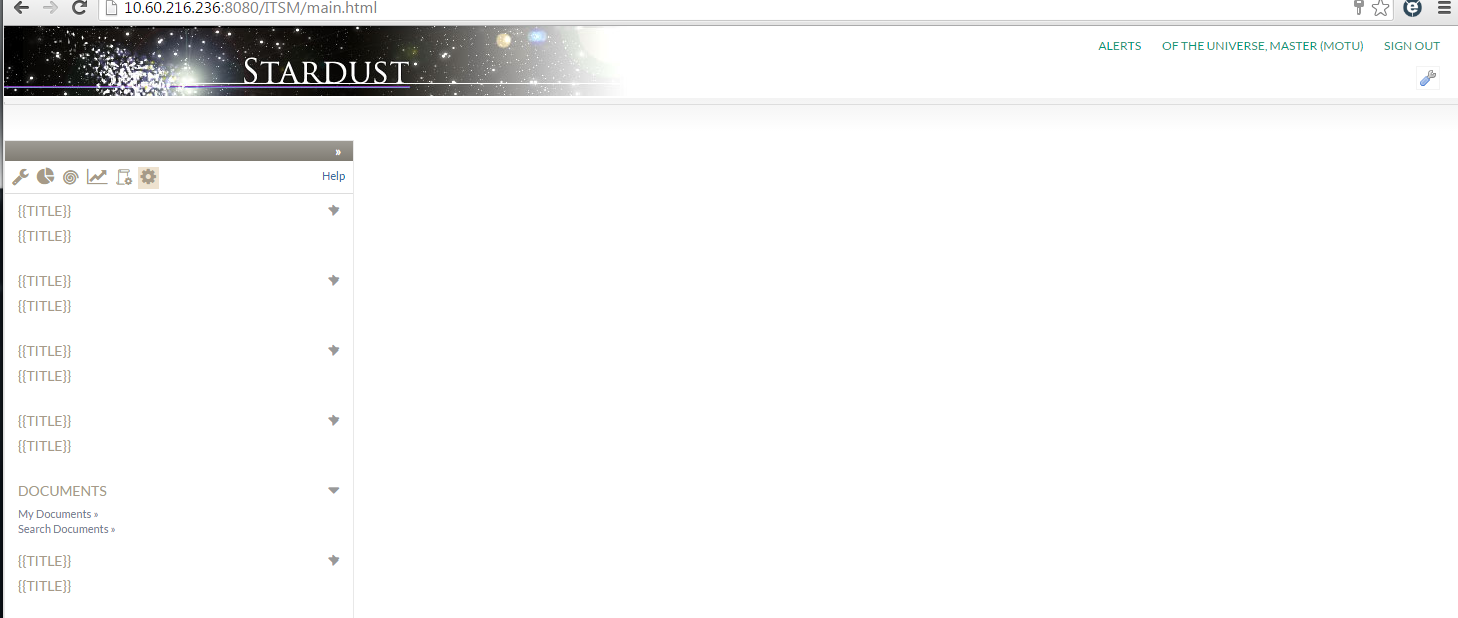

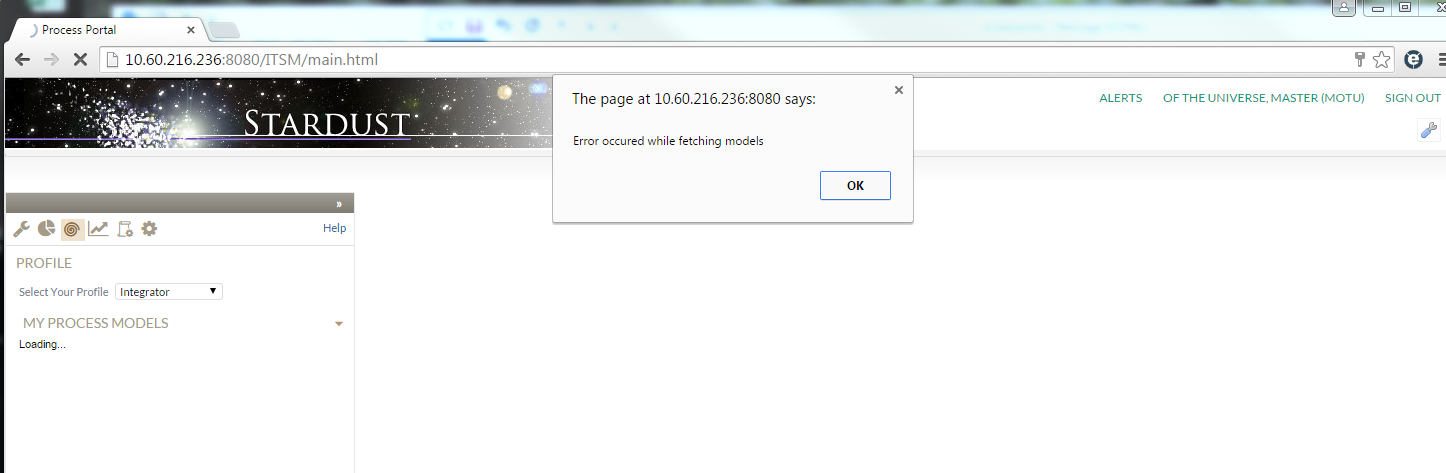

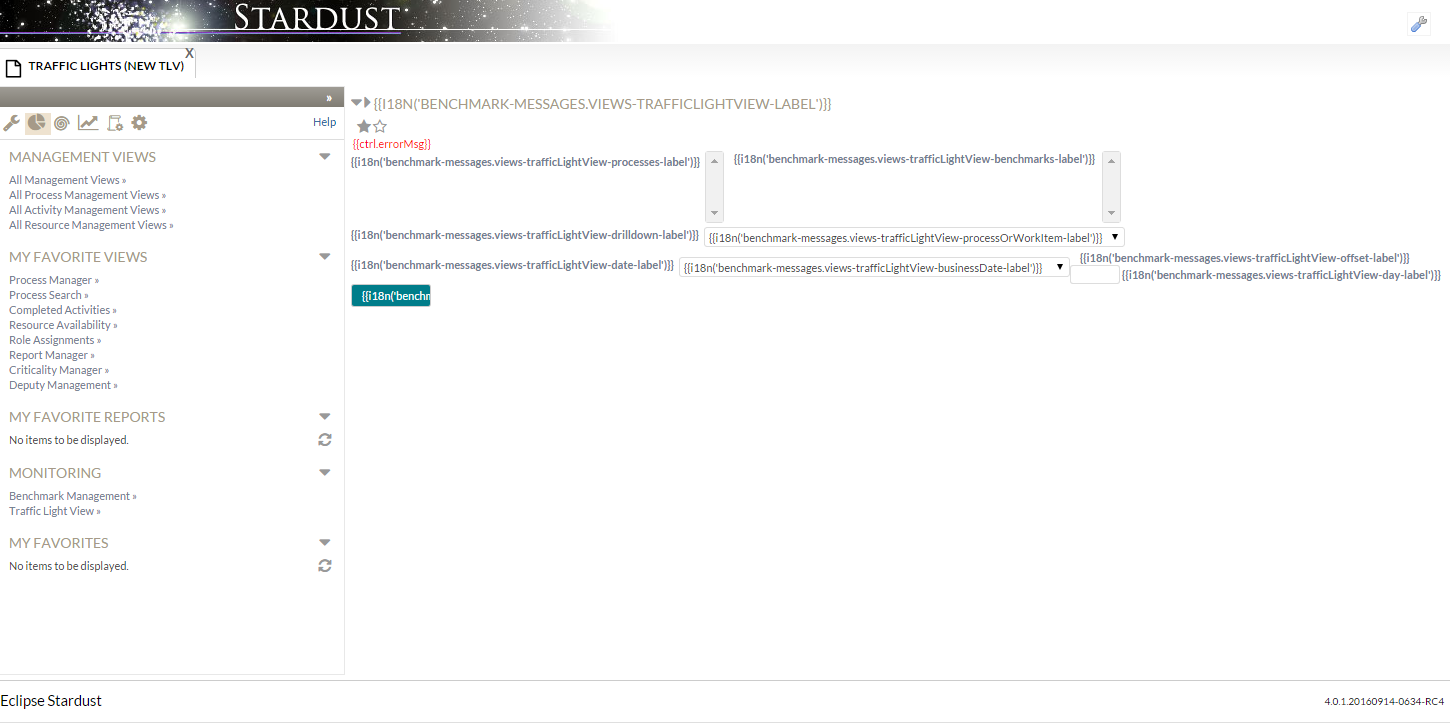

So i'm getting back to stardust after being a way awhile. Installed brand new copy of Neon.1, installed stardust via add new software ( nothing fancy.. ).
Got it up and running, accessed the portal and things went south from there.
In the default view, i get lots of labels saying "title" instead of the actual label. ( however the label for Documents, is there.. ). A number of menu entries in other views will pop up a new tab, with nothing in it. 'traffic light view' produces a bunch of I18n errors.. ( including some screenshots. )

Re: Portal problems on Neon.1 [message #1745994 is a reply to message #1745961] Thu, 20 October 2016 05:51 Go to previous messageGo to next message
Anthony, this seem related to i18n.
Have you tried different browsers / browser locales? What are your system locale, default browser local and available browser locales?
