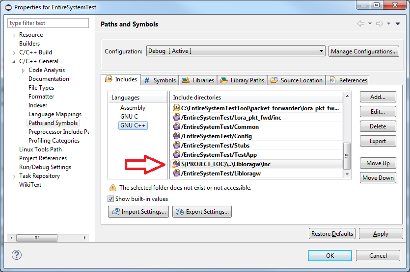

I have a folder containing multiple sources from various projects all being built together to generate a single executable. Having everything contained within a single folder and being able to have more than one copy on a PC would be very useful. So using relative paths is a pre-requisite. I have been trying to make paths defined in the "Paths and Symbols" (include tab) relative. The way to do this seems to be to use a predefined schema such as PROJECT_LOC. So something like
${PROJECT_LOC}\..\App\inc
The problem is that despite checking that the entry is resolved as expected by trying it on Resource->Linked Resource page a warning symbol is attached to the entry.
Once the warning symbol is attached to the entry it does not form part of the include list and the build fails. The only option is to enter an absolute path.
I have now given up but if anyone can assist I would appreciate it. Attached is a screen shot outlining the issue.

Hello David,
Thanks for replying. I can confirm that PROJECT_LOC (and WORKSPACE_LOC etc) are present. They should always be present as they are provided by Eclipse. To check this I viewed Project->Resource->Linked Resources using the Path Variables tab. They appear in the list but may not be edited. They can be used on the Linked Resources tab. As the Linked Resource is edited on this tab the "Resolved Location" is displayed which can be used to check syntax.
My gripe is that this mechanism seems to be broken when using the Project->C/C++ General->Paths and Symbols, "Includes" tab. Path variables defined by the user in Project->Resource->Linked Resources using the Path Variables may be used but the Eclipse supplied variables may not. As the user defined variables can only be defined as an absolute path a relative project seems out of reach.

I did try that. From within Paths & Symbols, on the include tab, I clicked Add and then pressed the Workspace button. I was prompted to "Select a folder from workspace:". However I could see some folders but not others, that it is the selection is not like file explorer. I suspect that other entries are affecting this view. There seems to be some correlation with the Linked Resources view. However I cannot add to these linked resources, only edit the entries. I was hoping I could simply point at an existing folder and include it.
