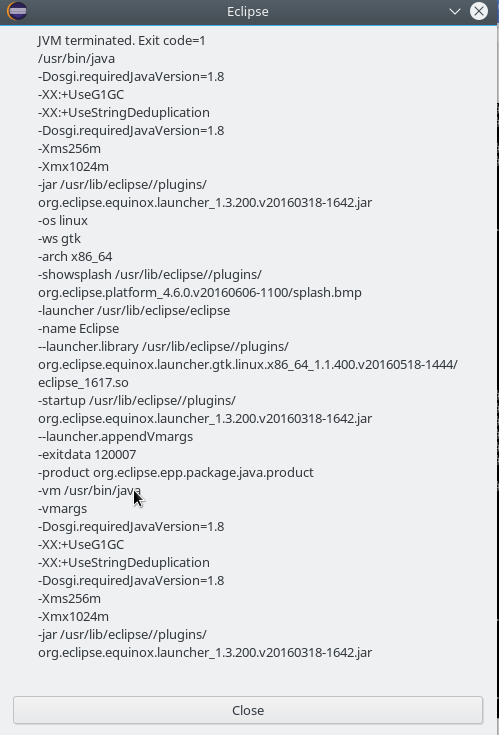

Hi! I'm trying to install eclipse on my arch linux distribution, I successfully installed eclipse-java on my machine but whenever I try to start it I get
Unrecognized VM option 'UseStringDeduplication'
Error: Could not create the Java Virtual Machine.
Error: A fatal exception has occurred. Program will exit.
Gtk-Message: GtkDialog mapped without a transient parent. This is discouraged.
and the dialog I will attach.
How do I solve this problem?
Re: Error or opening eclipse [arch linux] [message #1744373 is a reply to message #1744369] Mon, 26 September 2016 08:07 Go to previous messageGo to next message
I don't recognize some of those options. Older installations don't use that, but indeed, I see it in some of my newer installations in the eclipse.ini so they must be in your eclipse.ini. You could try deleting them.
Re: Error or opening eclipse [arch linux] [message #1744405 is a reply to message #1744373] Mon, 26 September 2016 11:33 Go to previous messageGo to next message
which ones in particular? 'UseStringDeduplication' ?
[Updated on: Mon, 26 September 2016 11:39] by Moderator
Re: Error or opening eclipse [arch linux] [message #1744421 is a reply to message #1744405] Mon, 26 September 2016 14:57 Go to previous messageGo to next message
I thought maybe that being unrecognized was bad. What version of Java is in /user/bin/java?
You say you installed eclipse-java but all the paths are kind of odd with eclipse//plugins, i.e., the // looks odd. Where exactly is your eclipse installation? Eclipse what's the full path to your eclipse.ini?
Re: Error or opening eclipse [arch linux] [message #1744428 is a reply to message #1744421] Mon, 26 September 2016 16:07 Go to previous messageGo to next message
How did you install Eclipse? Using eclipse.org's installer or some linux package manager?
Re: Error or opening eclipse [arch linux] [message #1744554 is a reply to message #1744428] Wed, 28 September 2016 04:50 Go to previous messageGo to next message
I installed it via arch's pacman
Re: Error or opening eclipse [arch linux] [message #1744580 is a reply to message #1744554] Wed, 28 September 2016 10:23 Go to previous message
Don't do that, get it directly from eclipse.org
See the Announcement message at the top of this newcomers forum titled Linux + Eclipse users, read this!
