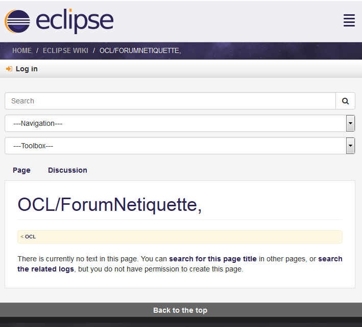

As for the "forum netiquette", the link is another "dead" one as pictured in the attached image.

Unfortunately punctuation got appended to https://wiki.eclipse.org/OCL/ForumNetiquette
Googling "OCL Forum Netiquette" also works.

What link is dead? just one that accidentally acquired trailing punctuation.
