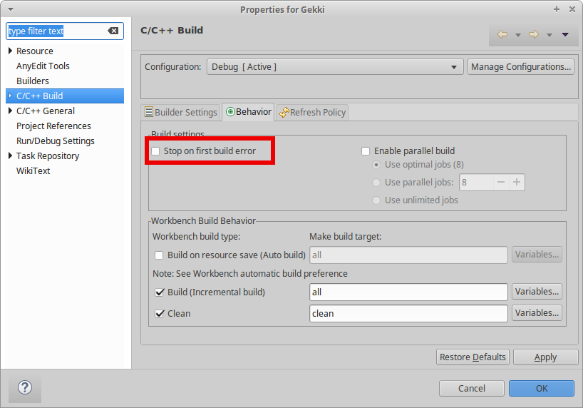

If your build is not stopping on first error it is probably because make is being run with -k switch.
You can turn the setting on/off in CDT if you open Project Properties -> C/C++ Build -> Behavior tab, and check "Stop on first build error"
Here is a screenshot to help:
index.php/fa/26784/0/

Thank you for your reply, However I'm triggering the build from cmd by eclipse command line options. Is there a solution for that from the CMD or setting this to be permanent in the work space it self?
Re: Eclipse will not stop building after the first error [message #1740942 is a reply to message #1740840] Sat, 20 August 2016 08:28 Go to previous message
Hi, your use case sounds like a patch is needed to CDT. It could be that the CDT command line build application never added support for make without -k.
