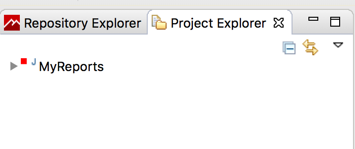

Everything works fine when I create the launch configuration and select my product id, except the appearance of the project folder inside the Project Explorer. The "J" decorator appears ok but the project icon is a "red square", the classic one used when the image is not found.
index.php/fa/26394/0/

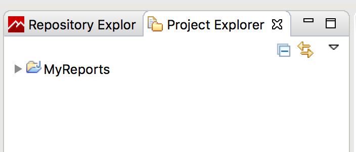

If I try to select another product id in the launch configuration (i.e. org.eclipse.platform.id or org.eclipse.sdk.ide) the icon is correctly shown.
index.php/fa/26393/0/
Not really sure of what's going on. In the console log there is no error that helps in determining the problem.
Any idea of what it could be? Is there any known bug?
Maybe I need to add some more dependencies? Anyhow this worked ok in 4.5.2.
