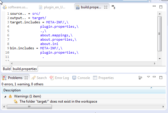

Is there a way to suppress the warning that there is no 'target/' directory? I have configured my '.project' file to ignore the target directory. Using the following XML stanza in the '.project' file.
<filteredResources>
<filter>
<id>1396938000000</id>
<name></name>
<type>10</type>
<matcher>
<id>org.eclipse.ui.ide.multiFilter</id>
<arguments>1.0-projectRelativePath-matches-true-false-target</arguments>
</matcher>
</filter>
</filteredResources>
index.php/fa/26209/0/
But I still get the warning.
  • Attachment: Snap1.png
    (Size: 29.21KB, Downloaded 654 times)
[Updated on: Sat, 18 June 2016 18:27] by Moderator

Well the question is why is that in your build.properties?
By default a plugin has no entry out..
Tom

Because I am using Tycho. 'target/' is the default for output.

Maven has target as output but tycho is using the build.properties. So
you don't need out..!
Tom
