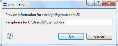

I think you are trying to clone the repository over Git SSH.
Is your SSH Key correctly updated on GitHub? When you try to clone the repository, did Eclipse prompt an "provide your passphrase" box like this one:
index.php/fa/26165/0/

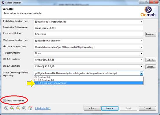

To change the way you clone the repository you should activate the checkbox "Show all variables" and switch the value in "repository": try "HTTPS (read-only, anonymous)".
index.php/fa/26166/0/
In that case, you will not be asked for any password and "git-clone" should work.

thank you Jeremie, changing to anonymous https did the job.
BTW: I don't know why, but the Scout RT import worked without changing anything.
