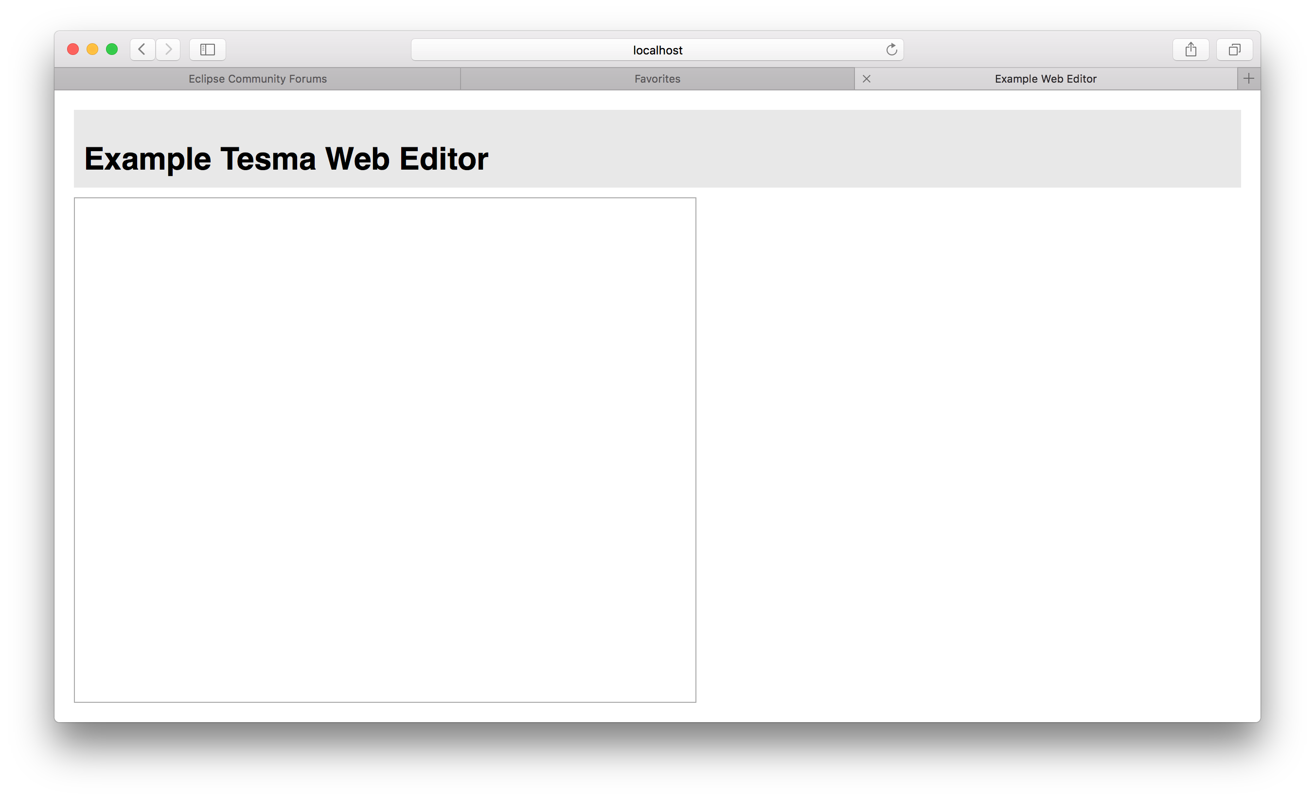

Thank you for your fast reply, well actually I've added in the MWE2Workflow in the language section the webSupport section : Here the code
language = StandardLanguage {
			name = "lu.uni.lassy.messep.tesma.Tesma"
			fileExtensions = "tes"
			serializer = {
				generateStub = false
			[i]webSupport = {
				generateHtmlExample = true
				framework = "CODEMIRROR"
			}[/i]
			validator = {
				// composedCheck = "org.eclipse.xtext.validation.NamesAreUniqueValidator"
and I've changed the script section in the index.html file to
require.config({
		    paths: {
		        "jquery": "webjars/jquery/<version>/jquery.min",
		        "xtext/xtext-codemirror": "xtext/<version>/xtext-codemirror"
		    packages: [{
		        location: "webjars/codemirror/<version>",
		        main: "lib/codemirror"
		require(["xtext/xtext-codemirror"], function(xtext) {
		    xtext.createEditor();
and then I've executed the jettyrun command, the server starts properly but the textbox is actually not editable in the web application, neither in chrome or safari.
In attachement, I've put a screenshot of the web browser.
Thank you in advance

Re: Xtext Web Editor [message #1734644 is a reply to message #1734639] Fri, 10 June 2016 03:20 Go to previous messageGo to next message
first question: did you give it a try with ace first (default setup)?
was it working?
did you adapt build.gradle for the codemirror web jar to be downloaded.
when you open the browser and have a look at the javascript console - which errors do you get ?
do you get any errors in the console of the jettyrun?

Re: Xtext Web Editor [message #1734740 is a reply to message #1734646] Fri, 10 June 2016 16:17 Go to previous messageGo to next message
Great Thank you for your help.. I made it actually run with the ACE standard version run after reinstalling a new Eclipse Java and updating with the Xtext update site. It was actually due to the low internet connection I had. It could not download a file (i do not remember the name) for making jettyrun run.
