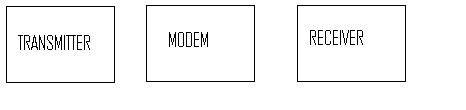

I have a problem that I am unable to solve.
I have a semantic element that contains some fields, one of these fields is made out of a java Enum (It means that the values can only be selected in a predefined set and are stored in an EList).
What I need to do is to display those values on a diagram instead of just in a list
Here is an example of what I have for the moment (List displayed on the property view) :
index.php/fa/26081/0/
And an outline of what I want to be displayed :
index.php/fa/26082/0/
I have tried to create a node mapping for those elements in the VSM but it is not working because the class of the elements on the list is not recognized (nothing is displayed)
Do you know if what I want to do is possible ?
Alexandre.

Re: Display properties semantic elements on diagram [message #1734538 is a reply to message #1734472] Thu, 09 June 2016 05:23 Go to previous message
Hi Julien,
Thank you very much it works !
I just did the enum literals finding inside a java service to make it a bit easier but the principle is the same.
Alexandre.
