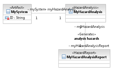

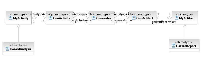

Re: Evaluate OCL constraints in an UML model programmatically [message #1735922 is a reply to message #1734161] Thu, 23 June 2016 12:06 Go to previous messageGo to next message
I got another problem in my new example. In this example, I would like to ensure an association connects the instances of stereotype "MyActivity" and "MyArtifact". Therefore, I have another stereotype "Generates" extends UML Association with constraint: Quote:
self.base_Association.memberEnd->collect(p:Property|p.class)->select(c:Class|c.oclIsKindOf(MyProfile::MyActivity))->size()=1
To simplify my question, I just remove the second part of statement from the constraint to check the other end of the association is an instance of "MyArtifact" or not. And I export my profile as image file in the attachment "myprof.png".
In my UML model, I have an instance of stereotype "HazardAnalysis" an instance of stereotype "HazaardReport", and an association between them(see myModel.png).
When I use the Xtext OCL console and evaluate the constraint using my program, I got "false" in both results.
Evaluating:
self.extension_Generates.base_Association.memberEnd->collect(p:Property|p.class)->select(c:Class|c.oclIsKindOf(MyProfile::MyActivity))->size()=1
Results:
false
Pivot constraint: context Generates invariant Activity generates Artifact: self.base_Association.memberEnd->collect(p:Property|p.class)->select(c:Class|c.oclIsKindOf(MyProfile::MyActivity))->size()=1
Target class: org.eclipse.uml2.uml.internal.impl.AssociationImpl@3015db78 (name: analysis hazards, visibility: <unset>) (isLeaf: false, isAbstract: false, isFinalSpecialization: false) (isDerived: false)
Validation result: false
To identify what the problem is, I wrote a simple constraint in my stereotype "HazardAnalysis" to check weather this stereotype is a subtype of "Activity". But this time I got different results in OCL Xtext console and my program. In the xtext tool, I still got "false" but the validation result of my program is "true"
Evaluating:
self
Results:
Domain::MyHazardAnalysis
Evaluating:
self.oclIsKindOf(MyProfile::MyActivity)
Results:
false
Pivot constraint: context HazardAnalysis invariant Hazard analysis is kind of Activity: self.oclIsKindOf(MyProfile::MyActivity)
Target class: org.eclipse.uml2.uml.internal.impl.ClassImpl@31da6b2e (name: MyHazardAnalysis, visibility: <unset>) (isLeaf: false, isAbstract: false, isFinalSpecialization: false) (isActive: false)
Validation result: true
I look into the implementation of class OclAnyOclIsKindOfOperation and found that the type of "sourceVal" is "ClassImpl" and sourceType is UML::Class when I evaluate my first constraint. But when I evaluate my second constraint "self.oclIsKindOf(MyProfile::MyActivity)", the type of "sourceVal" is "DynamicEObjectImpl" and sourceType is "MyProfile::HazardAnalysis" and then the evaluate result is "true".
I have couple questions about the results of my example:
1) Why I get different results for my second constraint using Xtext console and running the program?
2) It seems that I can only check weather an EObject is a subtype of a stereotype or not, but I can't check if an UML element is a subtype of a stereotype. Is this a restriction of OCL language?
P.S. I execute my examples using Eclipse Mars with OCL 5.1 and Eclipse Neon with OCL 6.1, and the results are the same.

Re: Evaluate OCL constraints in an UML model programmatically [message #1736112 is a reply to message #1735982] Sun, 26 June 2016 12:40 Go to previous messageGo to next message
I am confused about the type of a stereotyped element. Consider an OCL expression source.oclIsKindOf(Type), when source is a stereotyped element, the source's types should be UML metaclass and stereotype definition . But when I try the following ocl expression, I get confused about the execution results of my program. In the following examples, I can always get the same source element, MySystem, which is an instance of UML::Class and also an instance of stereotype definition MyArtifact.
The following OCL expressions has the same context, stereotype definition MyArtifact; and the evaluated element is my M1 model class MySystem.
1) Expression: MyProfile::MyArtifact.allInstances()->exists(p|p.oclIsKindOf(MyProfile::MyArtifact))
Result: true
Pivot constraint: context MyArtifact invariant test type of self and p : MyProfile::MyArtifact.allInstances()->exists(p|p.oclIsKindOf(MyProfile::MyArtifact))
Target class: org.eclipse.uml2.uml.internal.impl.ClassImpl@70e02081 (name: MySystem, visibility: <unset>) (isLeaf: false, isAbstract: false, isFinalSpecialization: false) (isActive: false)
2) Expression: MyProfile::MyArtifact.allInstances()->exists(p|p.oclIsKindOf(UML::Class))
Result: false
Pivot constraint: context MyArtifact invariant test type of self and p : MyProfile::MyArtifact.allInstances()->exists(p|p.oclIsKindOf(UML::Class))
3) Expression: UML::Class.allInstances()->exists(p|p.oclIsKindOf(MyProfile::MyArtifact))
Result: false
Pivot constraint: context MyArtifact invariant test type of self and p : UML::Class.allInstances()->exists(p|p.oclIsKindOf(MyProfile::MyArtifact))
4) Expression: UML::Class.allInstances()->exists(p|p.oclIsKindOf(UML::Class))
Result: true
Pivot constraint: context MyArtifact invariant test type of self and p : UML::Class.allInstances()->exists(p|p.oclIsKindOf(UML::Class))
5) Expression: self.oclIsKindOf(MyProfile::MyArtifact)
Result: true
Pivot constraint: context MyArtifact invariant test type of self and p : self.oclIsKindOf(MyProfile::MyArtifact)
6) Expression: self.oclIsKindOf(UML::Class)
Result: false
Pivot constraint: context MyArtifact invariant test type of self and p : self.oclIsKindOf(UML::Class)
In my test 1) and 2) p.oclIsKindOf(MyProfile::MyArtifact) is true but p.oclIsKindOf(UML::Class) is false. It seems that the type of p is my stereotype definition but not UML::Class
In my test 3) and 4) p.oclIsKindOf(MyProfile::MyArtifact) is false but p.oclIsKindOf(UML::Class) is true. In this case, it seems that the type of p is UML::Class but not my stereotype definition.
In my test 5) and 6) self.oclIsKindOf(MyProfile::MyArtifact) is true but self.oclIsKindOf(UML::Class) is false. The type of self is my stereotype definition but not UML::Class
Based on my test result, when an M1 element is a stereotyped element, I can only get one type of this element (either UML metaclass or stereotype definition).
My questions are:
1) Why I didn't get both types of a stereotyped element in the same time?
2) In what kind of situation, the type of a stereotyped element is UML metaclass? And in what kind of situation, the type of a stereotyped element is stereotype definition?
Best Regards,
Chung-Ling Lin

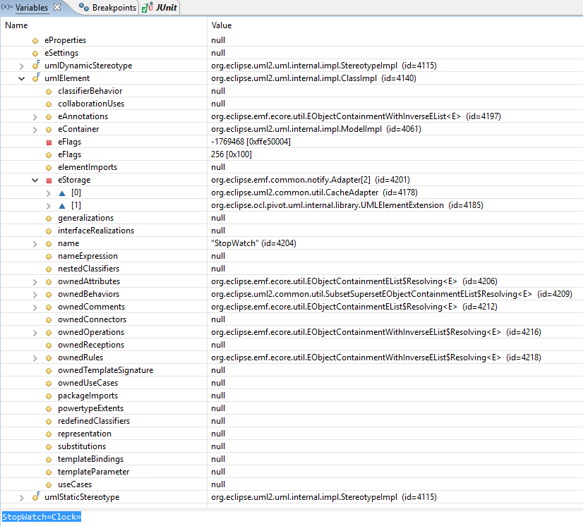

<div class="moz-cite-prefix">Hi<br>
<br>
At line 273 I see:<br>
<br>
<img src="https://www.eclipse.org/forums/index.php?t=getfile&amp;id=26417" alt=""><br>
<br>
showing that uee is a "StopWatch«Clock»"; i.e. an instance of the
Clock Stereotype applied to a StopWatch.<br>
<br>
uee.umlElement is StopWatch<br>
uee.umlDynamicStereotype is Clock<br>
uee.umlElement.eAdapters-&gt;includes(uee)  -- eAdapters is
magically cached within eStorage<br>
<br>
What is not there?<br>
<br>
    Regards<br>
<br>
        Ed Willink<br>

Thank you for the information. So the instance of UMLElementExtension itself is considered as an instance of a stereotype. And the implementation of the OCL evaluation does not provide a direct access to the instance of stereotype UML element in the M1 model.
And the UMLElementExtension has two fields of stereotype, the umlStaticStereotype and umlDynamicStereotype. In what kind of situation, an instance of UMLElementExtension will have different values in these two fields? If an instance of UMLElementExtension has different umlStaticStereotype and umlDynamicStereotype, which stereotype the OCL constraint will be evaluated on?
Best Regards,
Chung-Ling Lin

I have already answered both of these questions.
OMG UML (and so Eclipse UML2) provides no Stereotype instance; just a
bit of XMI magic.
A dynamic stereotype is distinct when one has been applied.
Ed Willink

Thank you again for the help. I read your explanation on 26-June again, but I am not understand about "However the instance of this compound at M0 is an instance of XXX with navigation relationships base_XXX/extension_YYY to an instance of an instance of YYY."
Therefore, I draw the models below to illustrate my understanding of the UML spec and your explanation.
http://i.imgur.com/zGhPIFh.png
Fig 1
http://i.imgur.com/X9Jd8oZ.png
Fig 2
Consider that we have a stereotype Clock extends metaclass Class, based on the UML spec, the notation of the extends relationship is represented as figure 1, and figure 2 shows that the extends relationship is an association between Class and Clock.
http://i.imgur.com/3aYjT7m.png
Fig 3
http://i.imgur.com/yL23qtt.png
Fig 4
Therefore, if I define a stereotyped element <<Clock>>StopWatch, the corresponding class diagram is shown in figure 3. If I use instance diagram notation to represent this M1 model as figure 4, the Extension between the Stereotype and the metaclass Class results in a link between the instance of Stereotype Clock and StopWatch.
http://i.imgur.com/WzBaaKv.png
Fig 5
Based on my understanding of your explanation, I draw the M0 diagram shown as figure 5. Therefore, the instance of this compound type, MyWatch, is an instance of StopWatch with navigation relationships base_Class/extension_Clock to an instance of an instance of Clock.
But what I don't understand is, since the extends relationship is defined as an association in M2, I understand that we have a link between the StopWatch and the instance of Clock in M1. Since MyWatch:StopWatch is an instance of StopWatch in M0, why this object still have a link to navigate the instance of instance of Clock?
Best Regards,
Chung-Ling Lin
