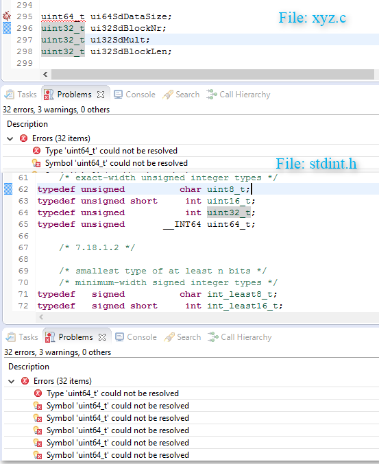

I do not understand why the indexer can resolve "uint32_t" but "uint64_t" it is not working.
Please see the screenshot.

You need to include stdint.h to use them. The indexer sometimes remembers definitions from other code when it shouldn't.
This is why it is so strange. I have included the stdint.h.
I do not think this is the case.
Actually when i set the cursor on the data type uint32_t(above the complaint with the uint64_t) and press F3 (go to definition) the file stdint.h appears with the according for uint32_t definition and below also with the definition for the datatype uint64_t.

Does your code compile?
What isunsigned __INT64? That's what is being called uint64_t. Is it defined?
The GCC definition (Linux x86 anyway) is typedef unsigned long long int uint64_t;.
There is a define : #define __INT64 __int64
in the same file directly at the beginning. Whereas __int64 has no further definitions. For the ARM CC Compiler it is OK, I mean when I compile the code inside uvision IDE it compiles without errors and warnings.

The indexer likely doesn't know what __int64 is. You can get around this by defining it just for the indexer,
Some place before including stdint.h maybe in a special include say MyStdInt.h
#ifdef __CDT_PARSER__
#define __int64 int
// or maybe
#define __int64
#endif
#include <stdint.h>
The preprocessor variable __CDT_PARSER__ is defined by the Indexer when it runs. It's a way to include things for the Indexer's benefit.
You could also try defining __int64 as a symbol on the project properties Paths and Symbols using the Symbols tab. I think that still works.
There are compiler defines being displayed in Preprocessor Include Paths, Macros etc. but there doesn't seem to be a way to add user defines. Or maybe there is,. I didn't try very hard.

I just wonder what the configuration of the OP is, a cross-compilation, maybe?
The indexer needs help for the built-in definitions, if the compilation is not targeted for the host processor / OS.
