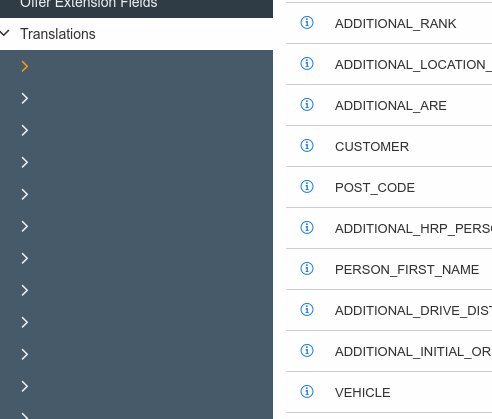

Also there is a new "bug" or a bug that will be a problem. I have attached a screenshot, maybe you know how to make it go away? note: we are not using the scout way of showing table items as entries on the right pane. The only thing that changed was the update from M5 to M7. There should be no items and/or the menu item should not be expandable (it is not configured!)

Ok, setting getConfiguredLeaf to true solved it (and no more empty expandable option)
