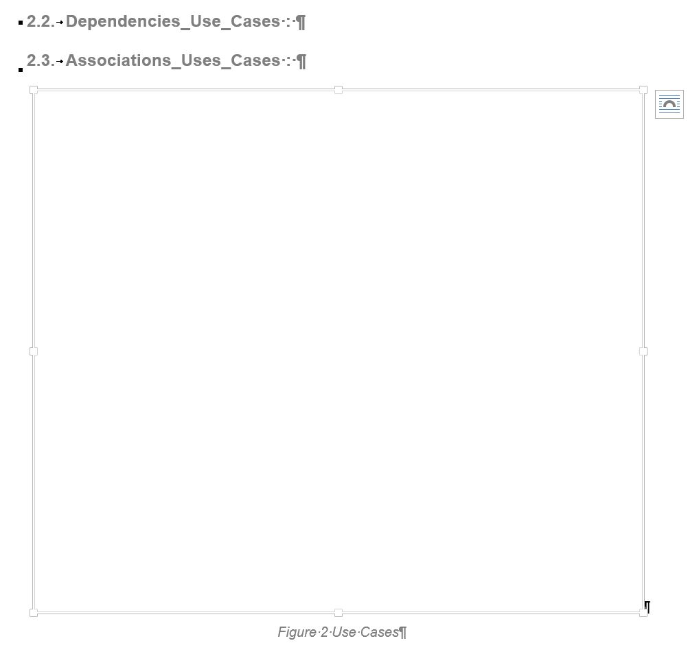

Hi All,
I am working on a gendoc template for msoffice document generation from UML Papyrus diagrams.
I have used this code:
[if (indP1.getPapyrusDiagrams()->size()>0)]<drop/>
[for (diag : Diagram | indP1.getPapyrusDiagrams())]<drop/>
<image object='[diag.getDiagram()/]' maxW='true' keepH='false'><drop/>
</image><drop/>
Figure 1 [clean(diag.name)/]
[/for]<drop/>
[/if]<drop/>
Gendoc generates the frame for the image and the legend of the image, but the frame is empty, i.e. the diagram image is not generated, only the name of the diagram is generated. Attached a screen shot of the generated document.
Any idea?
Saadia
  • Attachment: Capture.JPG
    (Size: 37.83KB, Downloaded 491 times)
Re: Problems when generating images from Papyrus diagrams [message #1729989 is a reply to message #1729922] Wed, 20 April 2016 12:52 Go to previous messageGo to next message
Hello
it looks like you use a recent version of Word. What is the version you are using ? The problem is maybe that.
Can you attach the docx template (or a non confidential and non working one) ?

Re: Problems when generating images from Papyrus diagrams [message #1730253 is a reply to message #1730215] Fri, 22 April 2016 12:20 Go to previous messageGo to next message
Concerning the empty frames I have opened a bug and submit a fix
https://bugs.eclipse.org/bugs/show_bug.cgi?id=492264
Can you try to download the nightly build of gendoc and see if it works for you ? (maybe you should uninstall gendoc first or restart from a fresh papyrus) :
https://hudson.eclipse.org/gendoc/job/Gendoc/ws/releng/org.eclipse.gendoc.update-site/target/repository/
Re: Problems when generating images from Papyrus diagrams [message #1730344 is a reply to message #1730253] Mon, 25 April 2016 04:27 Go to previous messageGo to next message
Hi Tristan,
I have juste tested after uptading gendoc from the nightly build.
The diagrams generation works with my template. Thanks for your help !
