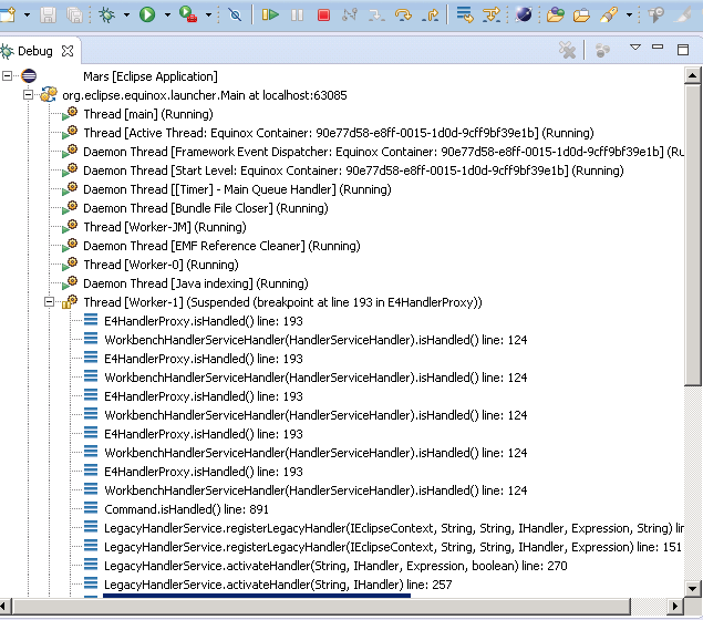

When migrating my product to Eclipse Mars, I start to have the following
messages on the console:
Conflicting handlers for system.test.myCmd:
(org.eclipse.ui.internal.workbenchHandlerServiceHandler@202c6396) vs
(system.test.MyHandler)
Once the workbench is loaded, I have a stack overflow !

I did some debugging and I see that when there is a conflict and the
method
LegacyHandlerService$HandlerSelectionFunction#compute(IEclipseContext,
String) return the workbenchHandlerServiceHandler as bestActivation, I
have the stack overflow which attached as image. When my handler is
returned, no stack overflow appears.
If in LegacyHandlerService#registerLegacyHandler(IEclipseContext,
String, String, IHandler, Expression, String), I comment out two lines
of code:
boolean handledChanged = handled != command.isHandled();
boolean enabledChanged = enabled != command.isEnabled();
My issue disappear !!

I only contribute this default handler and the conflict is with internal Eclipse handler !
When the internal Eclipse handler is returned I have the stack over flow.
I created the following bug:
https://bugs.eclipse.org/bugs/show_bug.cgi?id=491901
