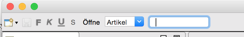

Re: Toolbar not draggable (RCP with compatibility layer) [message #1728503 is a reply to message #1728460] Tue, 05 April 2016 01:26 Go to previous messageGo to next message
Yes, I can drag toolbars in the IDE. For the RCP app: There is no output in the log (besides other non-ui related stuff).
index.php/fa/25531/0/
