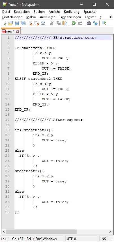

Hello to all,
there is a problem when I export my function block.
Structered text will be not translated right to cpp:
Please see attachment.
Is there anything wrong with my code? or is there a bug? or.....?
Thank you.
Wolfgang
  • Attachment: Unbenannt.jpg
    (Size: 87.97KB, Downloaded 132 times)
Re: Problem with translation from structured text to cpp [message #1728341 is a reply to message #1728225] Sat, 02 April 2016 06:01 Go to previous messageGo to next message
I assume you are pointing to the missing code for the second ELSEIF. Thanks for pointing this out there was an issue in the code generator. In 4DIAC-IDE cset 0d7d4a[1] this is fixed now and will go into 4DIAC-IDE 1.8.
Cheers,
Alois
[1] https://sourceforge.net/p/fordiac/fordiac-ide/ci/0d7d4acb99bb5fd7f610880a7dc6b38a4214f680/tree/

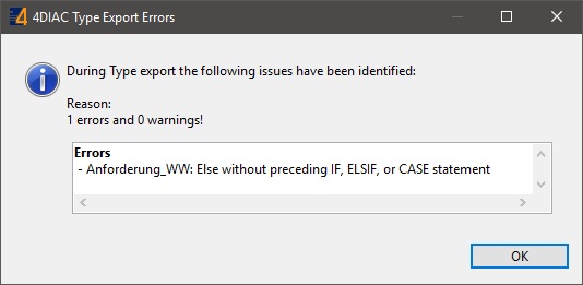

I've also noticed an error, when exporting this one
IF STATE THEN
	IF X < (Y + DIFF_EIN) THEN
		ANF:= TRUE;
		WW := Y;
	ELSIF X > (Y + DIFF_AUS) THEN
		ANF_WW := FALSE;
		WW := 5;
	END_IF;
ELSE
	IF X < (T + DIFF_EIN) THEN
	 	ANF:= TRUE;
	 	TWW := T;
	ELSIF X > (T + DIFF_AUS) THEN
		ANF_WW := FALSE;
		WW := 5;
	END_IF;
END_IF;
An error occured in 4DIAC:
Errors
- Anforderung_WW: Else without preceding IF, ELSIF, or CASE statement
  • Attachment: Error.jpg
    (Size: 29.79KB, Downloaded 406 times)
[Updated on: Tue, 12 April 2016 07:58] by Moderator
Re: Problem with translation from structured text to cpp [message #1729263 is a reply to message #1729211] Tue, 12 April 2016 09:06 Go to previous message
Is this already with my fix for your last issue?
