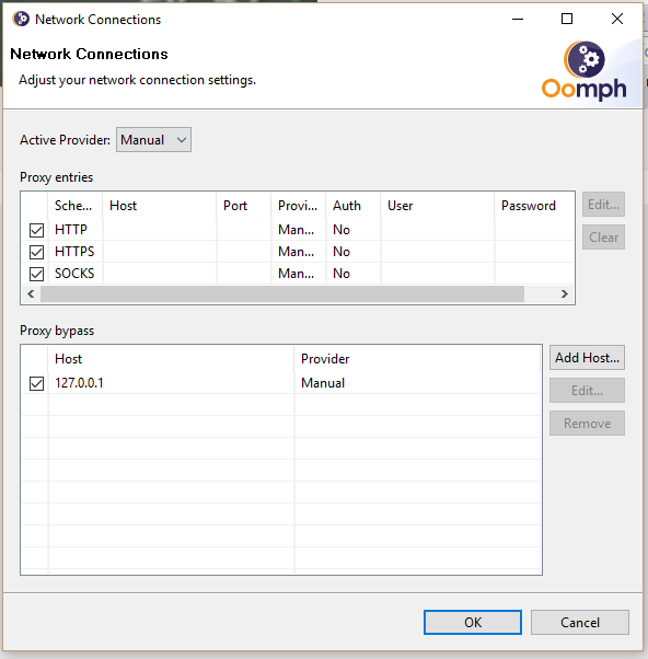

Re: eclipse installer problem [message #1741573 is a reply to message #1740966] Thu, 25 August 2016 18:57 Go to previous messageGo to next message
I don't see either of the above options in the installer menu.
First option is Configure Network Proxy, so I clicked that button assuming that's what you meant. It opens up this screen
index.php/fa/26882/0/
The dropdown box holds options Direct, Manual, Native.
I am also using no proxy's and have turned off my firewall to try to allow it. I'm on Windows 10.
I'm also attempting to find zip files of Neon, but if anyone can point me in the direction that would be helpful.

Re: eclipse installer problem [message #1749744 is a reply to message #1726222] Sat, 10 December 2016 13:47 Go to previous messageGo to next message
Hey. I just run the installer as an administrator. Hope it helps.
