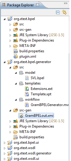

Re: generate a model .xmi xtext eclipse [message #1725954 is a reply to message #1725952] Tue, 08 March 2016 10:52 Go to previous messageGo to next message
i need to have like this
[Updated on: Tue, 08 March 2016 10:52] by Moderator
Re: generate a model .xmi xtext eclipse [message #1725955 is a reply to message #1725954] Tue, 08 March 2016 10:53 Go to previous messageGo to next message
srcGen i don't know how generate the model .xmi

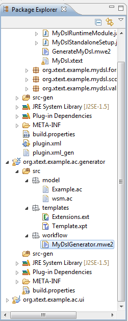

hi no it 's not what i ask about in the project i have an example wsm.ac when i run the generatot in workflow i should have a file in src-gen with extention .xmi
  • Attachment: boubou.png
    (Size: 22.23KB, Downloaded 172 times)
[Updated on: Wed, 09 March 2016 06:10] by Moderator

> models configured, using JavaBeans as default.
> 955 [main] DEBUG xt.validation.ResourceValidatorImpl - Syntax check
> OK! Resource:
> file:/D:/Nouveau%20dossier/eclipsehelio%20avec%20atl/workspace/org.xtext.example.ac.generator/src/model/Example.ac
> 1838 [main] DEBUG xt.validation.ResourceValidatorImpl - Syntax check
> OK! Resource:
> file:/D:/Nouveau%20dossier/eclipsehelio%20avec%20atl/workspace/org.xtext.example.ac.generator/src/model/wsm.ac
> 2054 [main] ERROR mf.mwe2.launch.runtime.Mwe2Launcher - Problems
> running workflow workflow.MyDslGenerator: Couldn't find EClass for
> name 'Greeting'.
> java.lang.RuntimeException: Problems running workflow
> workflow.MyDslGenerator: Couldn't find EClass for name 'Greeting'.
> at
> org.eclipse.emf.mwe2.launch.runtime.Mwe2Runner.run(Mwe2Runner.java:82)
> at
> org.eclipse.emf.mwe2.launch.runtime.Mwe2Runner.run(Mwe2Runner.java:52)
> at
> org.eclipse.emf.mwe2.launch.runtime.Mwe2Launcher.run(Mwe2Launcher.java:74)
> at
> org.eclipse.emf.mwe2.launch.runtime.Mwe2Launcher.main(Mwe2Launcher.java:35)
> Caused by: org.eclipse.emf.mwe.core.WorkflowInterruptedException:
> at org.eclipse.xtext.mwe.SlotEntry.findEClasses(SlotEntry.java:116)
> at org.eclipse.xtext.mwe.SlotEntry.put(SlotEntry.java:76)
> at
> org.eclipse.xtext.mwe.AbstractReader.addModelElementsToContext(AbstractReader.java:87)
> at org.eclipse.xtext.mwe.Reader.invokeInternal(Reader.java:166)
> at
> org.eclipse.emf.mwe.core.lib.AbstractWorkflowComponent.invoke(AbstractWorkflowComponent.java:126)
> at org.eclipse.emf.mwe.core.lib.Mwe2Bridge.invoke(Mwe2Bridge.java:34)
> at
> org.eclipse.emf.mwe.core.lib.AbstractWorkflowComponent.invoke(AbstractWorkflowComponent.java:201)
> at
> org.eclipse.emf.mwe2.runtime.workflow.AbstractCompositeWorkflowComponent.invoke(AbstractCompositeWorkflowComponent.java:31)
> at
> org.eclipse.emf.mwe2.runtime.workflow.Workflow.run(Workflow.java:19)
> at
> org.eclipse.emf.mwe2.launch.runtime.Mwe2Runner.run(Mwe2Runner.java:80)
> ... 3 more
