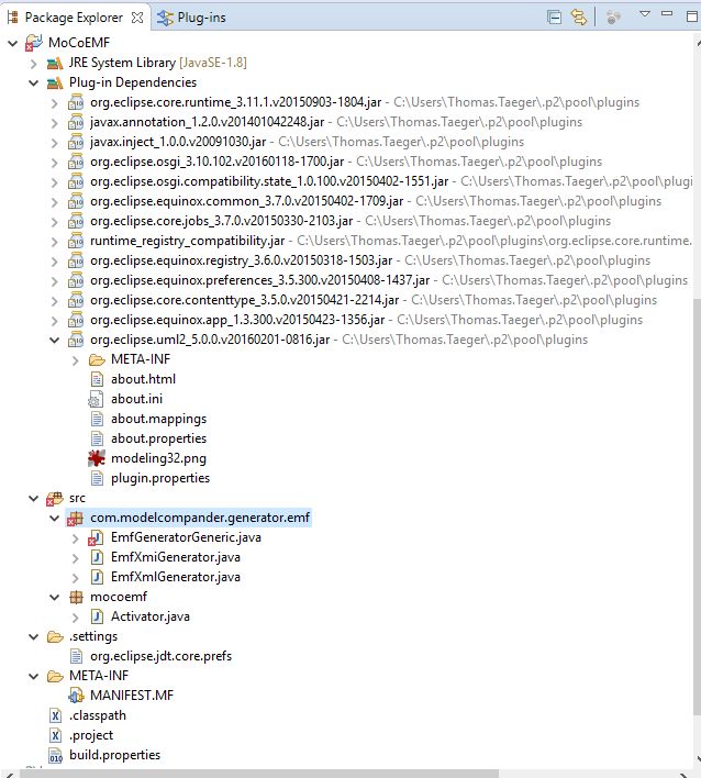

1. First I again tried to find the more actual jars for the imports and runtime dependencies via Help > Install new software:
- eclipse.jdt.core_3.1.0.jar
changed to -> org.eclipse.jdt.core_3.10.0.v20140902-0626.jar
- eclipse-emf-common-2.3.0.jar
changed to -> org.eclipse.emf.common_2.11.0.v20150805-0538.jar
- org.eclipse.emf.ecore.jar
changed to -> org.eclipse.emf.ecore_2.11.1.v20150805-0538.jar
changed to , Users\...\.p2\...\org.eclipse.emf.ecore_2.11.2.v20160208-0816.jar
- org.eclipse.emf.ecore.xmi.jar
changed to -> org.eclipse.emf.ecore.xmi_2.11.1.v20150805-0538.jar
changed to , Users\...\.p2\...\org.eclipse.emf.ecore.xmi_2.11.1.v20160208-0816.jar
- org.eclipse.uml2.common-1.5.0.v201005031530.jar
changed to -> Users\...\.p2\...\org.eclipse.uml2.common_2.1.0.v20160201-0816.jar
- org.eclipse.uml2.uml_3.1.1.v201008191505.jar
changed to -> Users\...\.p2\...\org.eclipse.uml2.uml_5.1.2.v20160201-0816.jar
- For org.eclipse.uml2.types.TypesPackage:
I tried -> Users\...\.p2\...\org.eclipse.uml2.types_2.0.0.v20160201-0816.jar
No success. So I removed these jars too from the project properties for preparing the next step:
Ed Willink wrote on Thu, 25 February 2016 17:52
If you just Configure->Convert to Plugin projects, [...]
2. Concerning "Configure Convert to Plugin projects":
In Eclipse > Package Explorer > MoCoEMF (my EMF project) > Context Menu > Convert there are several "Convert ..." offered, but no one like "Convert to Plugin projects". What is the right navigation?
I tried other navigations, e.g. via a new plug-in project:
Eclipse > File > New > Project > Plug-in Project > Next:
Project name: (MoCoEMF - already exists as non-plug-in
=> Error: A project with that name already exists in the workspace.)
Project name: MoCoEMF-plug-in
Use default location: (D:workspaces\trunk\MoCoEMF-plug-in)
Create a Java project: src, bin
Target platformm: This plug-in is targeted to run with: Eclipse version 3.5 or greater
> Next => Content:
Properties:
Version: 1.0.0.qualifier
Vendor: (none)
Execution Environment: JavaSE-1.8

Re: UnsupportedOperationException from Model and UMLPackage [message #1725095 is a reply to message #1725064] Mon, 29 February 2016 12:38 Go to previous messageGo to next message
Felix Dorner wrote on Mon, 29 February 2016 13:42
You then double click on its 'plugin.xml' or META-INF/MANIFEST.MF file [...] Now there is the list of all "jars" that you would need to start coding against uml2.
Yes, perfect so far.
But the import statements still are red and do not recognize the jars, see the both images:
http://www./thomastaeger.de/img/MoCoEMF-PackageExplorer-initial.jpg
http://www./thomastaeger.de/img/MoCoEMF-imports-initial.jpg
Thank you so much - Thomas
Re: UnsupportedOperationException from Model and UMLPackage [message #1725110 is a reply to message #1725095] Mon, 29 February 2016 15:57 Go to previous messageGo to next message
Thomas Taeger wrote on Mon, 29 February 2016 17:38
But the import statements still are red and do not recognize the jars.
OK, I got the jars to be activated by selecting all the jars in C:\Users\Thomas.Taeger\.p2\pool\plugins - ca. 2,200 jars! - and adding them to the libraries via
Eclipse > package Explorer > MoCoEMF > Project > Properties > Java Build Path > Libraries > Add external jars > Select all > Open
But I can not believe that this is the normal procedure because in Eclipse > Package Explorer > MoCoEMF > JRE System Library there are just 18 jars listed - maybe even more than I really need.
I thought that .p2 would stop that nonsense? But how to reduce that lot of jars to just the needed ones efficiently?
Or, even better, how to automate?
Best regards - Thomas

Re: UnsupportedOperationException from Model and UMLPackage [message #1725112 is a reply to message #1725110] Mon, 29 February 2016 15:59 Go to previous messageGo to next message
> them to the libraries via Eclipse > package Explorer > MoCoEMF >
> > Select all > Open
Noooooooooooooooooooooooooooooooooooooooooooo!
Literally, never never never never edit the build path of a plugin
through anything else but the PDE Manifest editor.
Re: UnsupportedOperationException from Model and UMLPackage [message #1725113 is a reply to message #1725112] Mon, 29 February 2016 16:35 Go to previous messageGo to next message
Felix Dorner wrote on Mon, 29 February 2016 20:59
... never edit the build path of a plugin through anything else but the PDE Manifest editor.
Ok, a new component comes into play, the "PDE Manifest editor". For me the learning curve is pritty moderate.
Instead of thinking about what NOT to do I am urgendly seaking the way how to do.
How am I to reduce the jars in Project > Properties > Java Build Path > Libraries ?
Just leaving them off and letting p2 doing the job does not work (as I tried).

Hi Felix, today I am trying with a fresh install of Eclipse and EMF. I
- Removed the old Eclipse directory
- Downloaded actual eclipse-jee-mars-R-win32-x86_64.zip
- Unzipped it to new Eclipse directory C:\progs\
- Started Eclipse for setting the workspace
| End
EMF-Installation:
https://www.eclipse.org/modeling/emf/downloads/? => emf-xsd-Update-2.11.1.zip
containing binary\, features\, plugins\ and 2 jars
Unzip emf-xsd-Update-2.11.1.zip to C:\progs\eclipse\ => merging features\ and merging plugins\ without overwriting any
Eclipse | Package Explorer | MoCoEMF | Project | Properties | Java build path | Libraries:
Removed the old emf and uml2 jars =>
only JRE System Library [JavaSE-1.8] and Plug-in Dependencies (all based on the new directory C:\progs\eclipse\plugins\) | Ok
Eclipse restart
Eclipse | Package Explorer | MoCoEMF | Project | Properties | Plug-in Development | Runtime Classpath: /MoCoEMF/bin | OK
Eclipse restart
The imports that my program needs are:
// C:\Users\Thomas.Taeger\.p2\pool\plugins\:
// org.eclipse.emf.common_....jar:
import org.eclipse.emf.common.util.EList;
import org.eclipse.emf.common.util.URI;
// org.eclipse.emf.ecore._....jar:
import org.eclipse.emf.ecore.resource.Resource;
import org.eclipse.emf.ecore.resource.ResourceSet;
import org.eclipse.emf.ecore.resource.impl.ResourceSetImpl;
// org.eclipse.emf.ecore.xmi_....jar
import org.eclipse.emf.ecore.xmi.impl.XMIResourceFactoryImpl;
// org.eclipse.uml2.types_....jar:
// org.eclipse.uml2.uml_....jar:
import org.eclipse.uml2.uml.Class;
import org.eclipse.uml2.uml.Classifier;
import org.eclipse.uml2.uml.Interface;
import org.eclipse.uml2.uml.Model;
import org.eclipse.uml2.uml.NamedElement;
import org.eclipse.uml2.uml.Operation;
import org.eclipse.uml2.uml.Package;
import org.eclipse.uml2.uml.Port;
import org.eclipse.uml2.uml.Property;
import org.eclipse.uml2.uml.Type;
import org.eclipse.uml2.uml.UMLFactory;
In Eclipse | Package Explorer | MoCoEMF | META-INF | MANIFEST.MF | Dependencies:
org.eclipse.core.runtime exists, but org.eclipse.uml2[.uml] not yet =>
| Add... | Select a Plug-in:
org.eclipse.uml2[.uml] is not offered => I need that target platform | Cancel
Getting a target definition and setting it as the target platform:
Eclipse | Window | Preferences... | Plug-in Development | Target Platform
| Add... => "Create a target definition":
Here I got lost:
Initialize the target definition with: Default target for the running platform
=> "Target Content":
Name: "EMF Platform" (instead of "Running Platform")
Locations: ${eclipse_home} 924 plug-ins available
Content:
|v| ... all selected ...
| Add: ????
Implicit Dependencies
| Add... ????
Can you please help me with creating a target definition?
