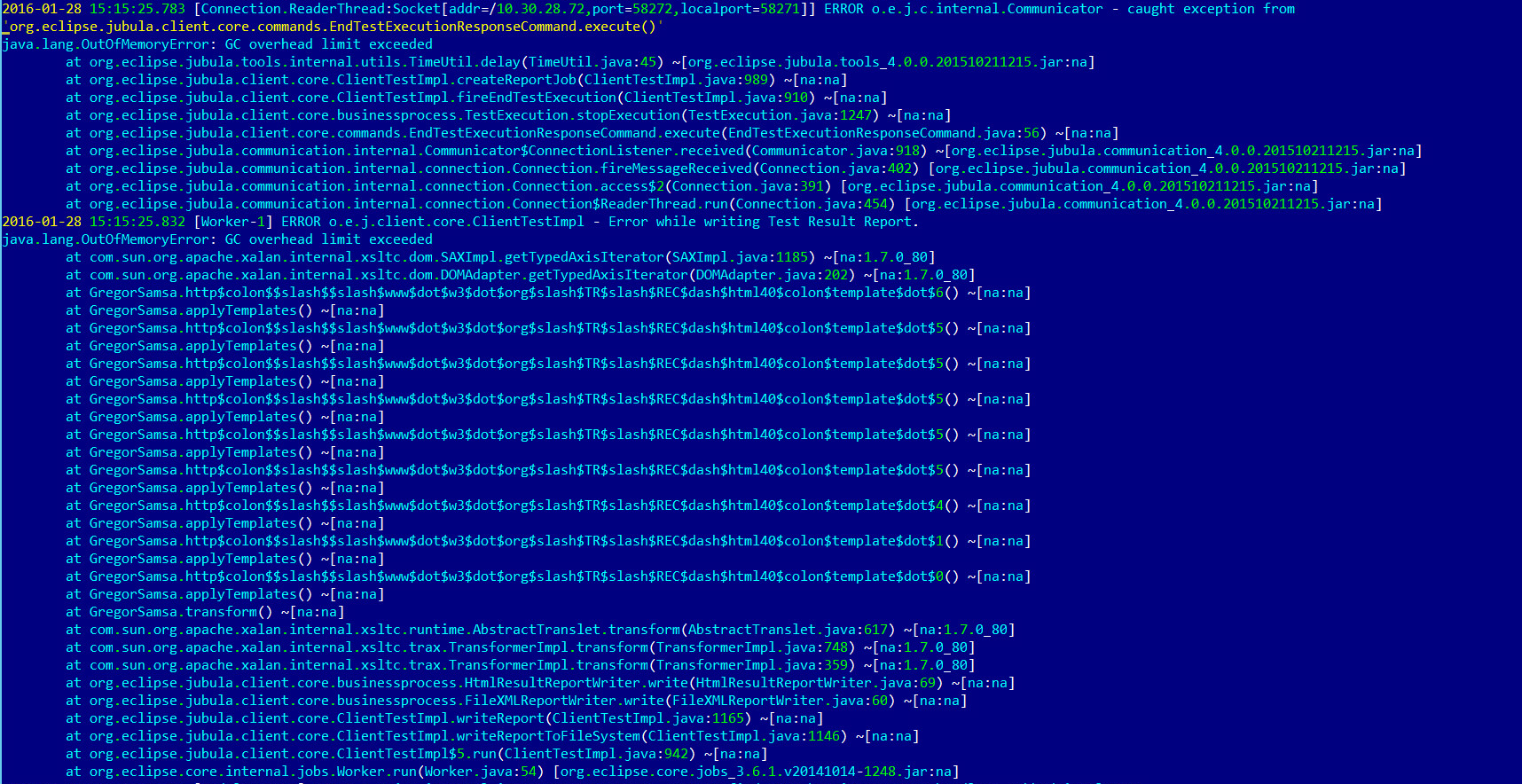

Re: Testexec - report only failed tests [message #1722211 is a reply to message #1722153] Wed, 03 February 2016 07:15 Go to previous messageGo to next message
Stack trace from client.log:
index.php/fa/24873/0/
Here is statistic of testset (please note, it does not fail with OOM now. When it failed there were more executed CAPs (run time was one hour more) and lots of screenshots since many tests were failing. When OOM occurred xml report was created (~130Mb) and HTML report with zero length):

Re: Testexec - report only failed tests [message #1722699 is a reply to message #1721705] Mon, 08 February 2016 06:49 Go to previous messageGo to next message
Hi Alexander,
There is a way to raise the memory for the testexec if you are using a 64 Bit version. If you are having a 32 Bit version of jubula it is already at a very high level.
If you want raise it for your 64 Bit Jubula, you must raise the -Xmx value in the testexec.vmoptions
Also we have the options for the testexec not to do Screenshots at all("-s") or not to write Screenshots to XML/HTML since this is sometimes using a lot of space ("-sx").

Re: Testexec - report only failed tests [message #1722809 is a reply to message #1722699] Tue, 09 February 2016 05:09 Go to previous message
Hi Marvin,
I have already increased Xmx for testexec, however large html reports are hard to view in browsers.
