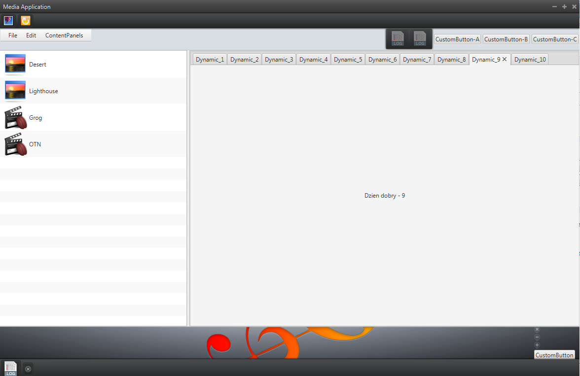

1. I used modified application from e(fx)clipse sample - http://wiki.eclipse.org/Efxclipse/Tutorials/Tutorial3 - (JavaFx -> Samples -> e4 Media Application)
2. I show let say 10 views in editor
3. Select 9th tab. View-9 will be shown in editor. See tab_header_in_editor_1.png

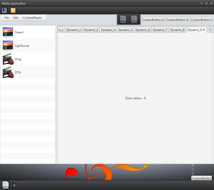

4. Shrink width of the application so that there is no enough place for all tab headers. Header 10. is hidden and header 9. is shown partially. See tab_header_in_editor_2.png

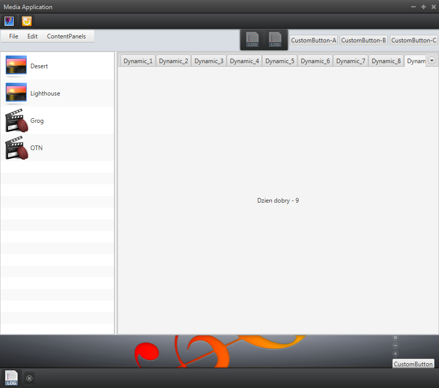

5. Click on tab-8 and then tab-9. Headers 9 is again shown correctly. See tab_header_in_editor_3.png
Expected result. After step 4 tabs headers should be painted/layouted exactly the same as after step 5 - whole active tab's header must be visible as it is in native SWT eclipse. You can check it starting eclipse IDE.

This is out of control of e(fx)clipse because this is the native
JavaFX-TabFolder.
So we need to file a bug report against OpenJFX. Feel free to file a bug
against e(fx)clipse as well, maybe we can find a work around as well.
